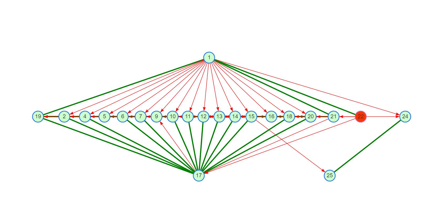

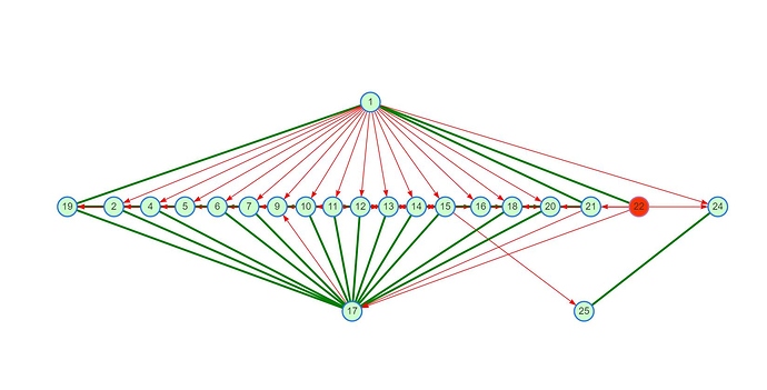

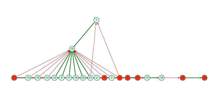

My zwave network has become sluggish and unreliable, looking at the 2 screenshots you can see that before a reboot (bottom image) the network doesn’t look great, after a reboot it looks better (top image). Any ideas why this would be?
Neither screenshot show what i would consider to be a mesh network, does the look right though for zwave?

hmmm, every now and then the 2 nodes in the garden shed just stop responding and appear as orphaned on the network map. I plug them in in the house for a few day and they sort themselves out and then i put them back in the shed again…till next time
Possibly because the Heal until today had an issue that left threads hanging that were only released when the server was restarted if it failed.
Chris posted it was fixed a few hours ago.
Now you may or may not gain from running heal every day but unless there are big changes in your network you may be better not to but moving two nodes into the house and back is not great.
It might be that the heal and the moving nodes is causing you more problems than it solves.
