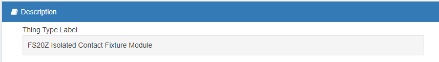

The device that will not get recognized looks like this in Habmin
The Attributes section provides the type:id (useful to look it up in the db) and firmware version. But if you have another, then you know that is not the problem! Unrecognized mains powered device… hmmm… my advice is to power cycle it. If that doesn’t work, reinitialize it. If that doesn’t work, exclude and reinclude.
