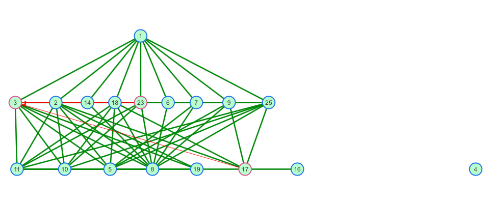

This is what Habmin shows me:

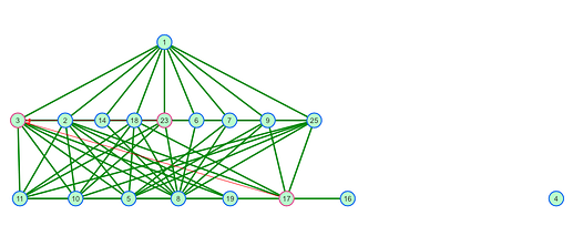

I’ve noticed that the zwave device only has 1 neighbour: node 2. But that node is further away than other nodes. I’ve tried to heal the device, but it fails → it gets offline.
