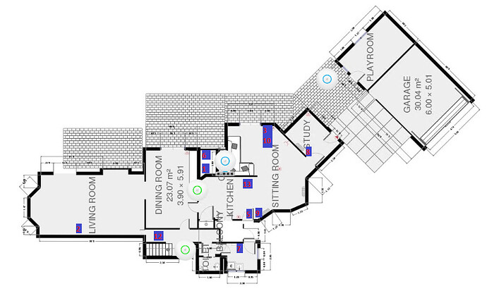

I can’t figure out why this node 6:
Would not be able to set the controller node as a neighbour. Even though, they’re about 1.5m from each other. Where
Are probable the distance away. If measuring in a straight line. 6 and the controller are in the same room, everything else has at least one wall
Numbers a bit hard to see, but you can see 6 and 1 inthe middle, 2 inthe left living room, 9 by 5 in the sitting room/kitchen

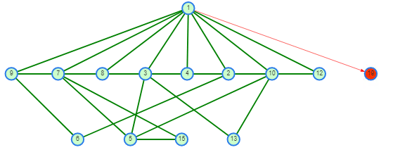

So the issue with 19m, was that it was actually wired wrong, every time the physical switch was hit it cut power entirely…so it never was able to stay up long enough to fix.
Now that solved, now I have an issue with node 9 (a lamp between the kitchen, sitting room). Right next to another node and about 1 meter from 13, and probably 3 m from the controller.
It’s started dropping when sending it a command…and going offline according to openhab…but then the meter comes in from the device and it wakes up gets the info, and maybe half processes a command before going offline again, especially during a heal.
