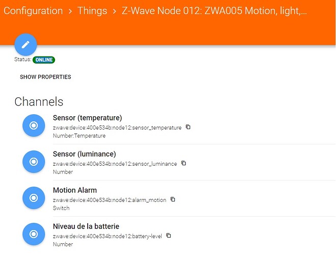

For the last three weeks, I have been trying to add my first ever sensor (Aeotec TriSensor -Model: ZWA005-A) to my openhab 2.5.0.M1 using the ZWave stick (Aeon Labs Aeotec Gen5 Z-Wave Plus – ZW090) and I am not getting any information from the device.
The Z-Wave binding did recognize the TriSensor but I am not getting any information from it neither in the Control panel of the PAPER UI nor from any rules.

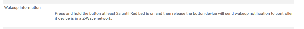

Today, I have made some progress. In the TriSensor user guide (Tri Sensor User Guide : Aeotec Help Desk), there are the following instructions on the button pressing functions:
I tried almost every function except the “Press and hold for 15 seconds” for Factory Reset. The “Press and hold for 5 seconds” for the 5 minute Wakeup did not help me. In all my attempts, I got the feeling that it was a combination of “Press and hold for 9 seconds” for Health Test and “Tap once (when paired)” to send NIF that advanced the initialization process to the point that now my I getting the Motion, Temperature and Light information via a rule. Here the zwave log associated to this big progress.

I had a different sensor with the same instructions and found a triple press woke it up. I saw the results with zwave debugging turned on.

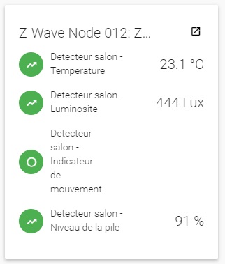

Now from PAPER UI - Control panel, I am getting Temperature, Light and battery level information but not the motion switch information.
However, via rule, I am getting all the information from this sensor including the battery level information. That makes me wondering, why we need the XML file…:face_with_raised_eyebrow:

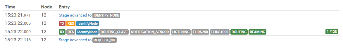

Yesterday, I tried the button triple press suggested by Bruce. At first nothing changes. However after I disable and enable the node 12 thing from the “PAPER UI - Configuration - Things” screen, I finally get the initialisation process completed (NODE 12: Device initialisation complete) and with it, the creation of the XML. Here the zwave log.:slightly_smiling_face:
zwave-log7.txt (4.2 KB)

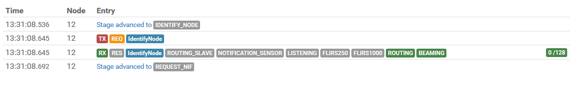

I tried again the button triple press, disabling and enabling the node 12 thing from the “PAPER UI - Configuration - Things” screen, but nothing really changes. Here the zwave log.
zwave-log9.txt (24.8 KB)

I think I have noticed that too, but Paper UI is designed only for OH administration. I see proper motion switched in the Basic UI.
