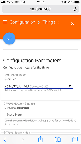

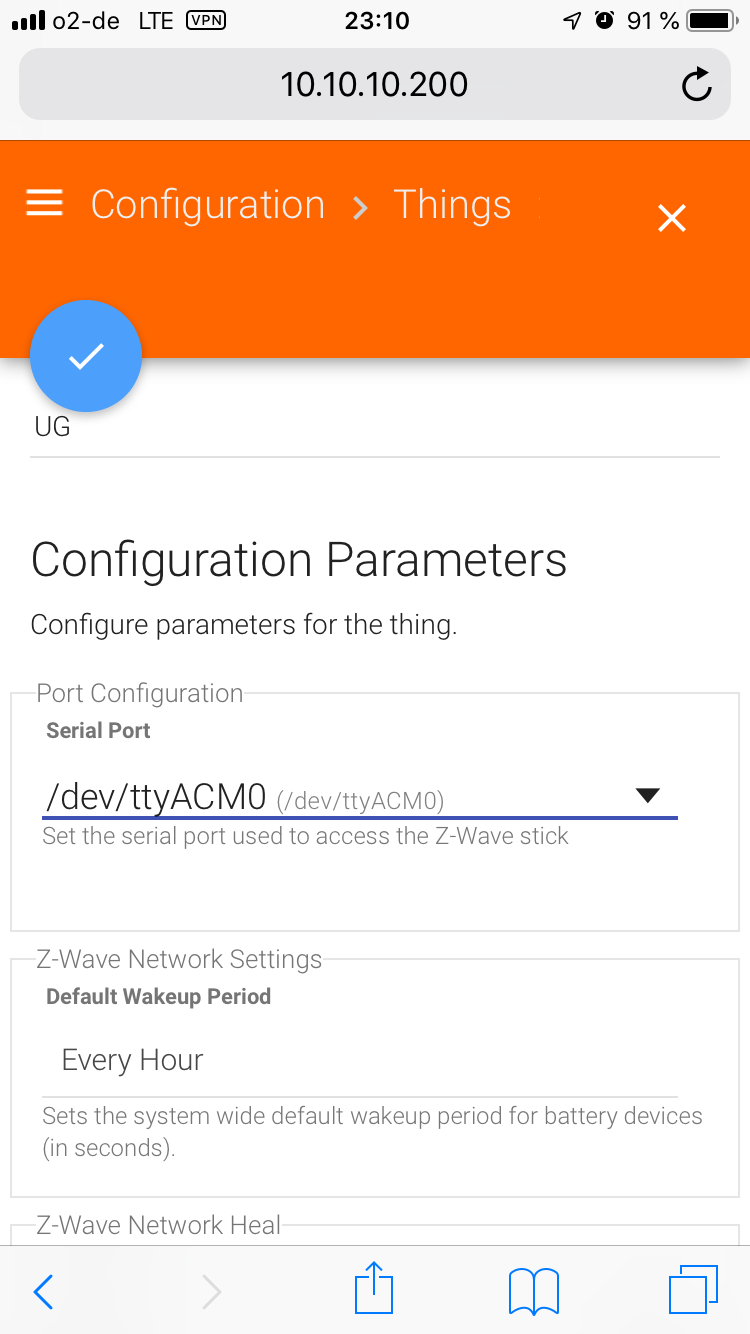

I tried different times, with correct port chosen will be on vacation shortly and no chance to test again before, I went back to 1551 build, runs stable at me

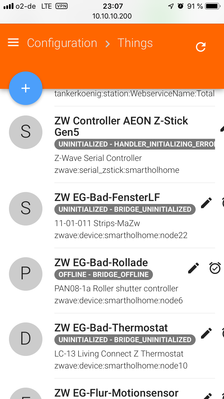

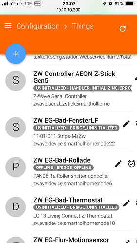

Tested via vpn again, log shows errors for zwave:
019-04-09 23:07:35.392 [ERROR] [nal.common.AbstractInvocationHandler] - An error occurred while calling method ‘ThingHandler.initialize()’ on ‘org.openhab.binding.zwave.handler.ZWaveSerialHandler@68e051b0’: null
2019-04-09 23:07:35.414 [ERROR] [core.thing.internal.ThingManagerImpl] - Exception occurred while initializing handler of thing ‘zwave:serial_zstick:smartholhome’: null
Errors for jdbc:
2019-04-09 23:18:08.804 [ERROR] [ence.internal.PersistenceManagerImpl] - Exception occurred while querying persistence service ‘jdbc’: null
2019-04-09 23:18:09.168 [ERROR] [org.knowm.yank.Yank ] - Error in SQL query!!!
2019-04-09 23:18:09.170 [ERROR] [nal.common.AbstractInvocationHandler] - An error occurred while calling method ‘QueryablePersistenceService.query()’ on ‘org.openhab.core.persistence.internal.QueryablePersistenceServiceDelegate@1adf62aa’: null
Zwave don’t came up, see screenshots from paperui
Downgraded to 1562… every thing is working
