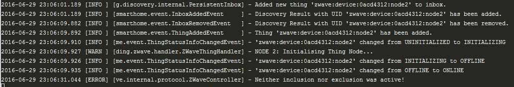

I choose Z-Wave Binding in Habmin and put the sensor in inclusion mode:
It’s found as thing - but theres no node2.xml in the zwave-folder:

So I’m excluding node2.
And reinclude it again:
It gets anothe name as before.
The sensor is detecting motion and magnet-open-state.
But there’s no feedback in the log-tail or in the items…
What do I do wrong? Where’s my problem?
