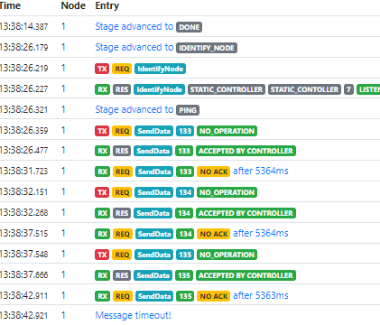

The zwave controller and devices all show as ONLINE in the Things UI. But they are not working - no information is being exchanged as far as I can see.
Here is the DEBUG openhab.log as displayed on the Zwave Log Viewer (minus the color which didn’t copy). This captures an openHAB start up.

23:59:54.757	10
TX REQ DeleteSUCReturnRoute NODE 10
23:59:54.760
RX ACK 0 /128
23:59:54.874	10
RX RES DeleteSUCReturnRoute STARTED 0 /128
00:00:02.405	10
RX REQ DeleteSUCReturnRoute FAILURE 0 /128
00:07:21.507	14
TX REQ DeleteSUCReturnRoute NODE 14
00:07:21.508
RX ACK 0 /128
00:07:21.831	14
00:07:30.197	14
00:07:39.242	3
TX REQ DeleteSUCReturnRoute NODE 3
00:07:39.244
RX ACK 0 /128
00:07:39.253	3
00:07:45.492	3
00:11:44.999	11
TX REQ DeleteSUCReturnRoute NODE 11
00:11:45.001
RX ACK 0 /128
00:11:45.424	11
00:11:54.419	11
00:13:01.000	5
TX REQ RequestNodeInfo
00:13:01.001
RX ACK 0 /128
00:13:04.143	9
TX REQ DeleteSUCReturnRoute NODE 9
00:13:07.782	9
RX RES RequestNodeInfo OK 0 /128
00:13:07.786
RX CAN 0 /128
00:13:14.269	5
RX REQ ApplicationUpdate UPDATE_STATE_NODE_INFO_REQ_FAILED 0 /128
00:26:36.071	10
00:26:36.073
RX ACK 0 /128
00:26:36.187	10
00:26:43.718	10
00:29:38.706	3
00:29:38.707
RX ACK 0 /128
00:29:38.716	3
00:29:44.957	3
00:35:13.769	11
00:35:13.771
RX ACK 0 /128
00:35:14.297	11
00:35:23.284	11
00:36:59.263	9
00:36:59.264
RX ACK 0 /128
00:36:59.791	9
00:37:04.802	14
00:37:07.471
RX ACK 0 /128
00:37:07.474	14
00:37:08.781	14
00:40:23.145	5
00:40:23.147
RX ACK 0 /128
00:40:29.926	5
00:40:36.413	5
00:51:38.159	3
00:51:38.161
RX ACK 0 /128
00:51:38.169	3
00:51:44.407	3
00:53:17.426	10
00:53:17.427
RX ACK 0 /128
00:53:17.542	10
00:53:25.069	10
00:58:42.647	11
00:58:42.648
RX ACK 0 /128
00:58:43.174	11
00:58:52.166	11
01:00:57.933	9
01:00:57.941
RX ACK 0 /128
01:00:58.467	9
01:01:07.454	9
01:06:43.118	14
01:06:43.119
RX ACK 0 /128
01:06:43.442	14
01:06:51.805	14
01:07:45.291	5
01:07:45.293
RX ACK 0 /128
01:07:52.071	5
01:07:58.557	5
01:13:37.615	3
01:13:37.617
RX ACK 0 /128
01:13:37.626	3
01:13:43.866	3
01:19:58.763	10
01:19:58.766
RX ACK 0 /128
01:19:58.881	10
01:20:06.412	10
01:22:11.520	11
01:22:11.521
RX ACK 0 /128
01:22:11.946	11
01:22:20.935	11
01:24:56.600	9
01:24:56.603
RX ACK 0 /128
01:24:57.129	9
01:25:06.120	9
01:35:07.436	5
01:35:07.438
RX ACK 0 /128
01:35:14.219	5
01:35:20.706	5
01:35:37.072	3
01:35:37.074
RX ACK 0 /128
01:35:37.083	3
01:35:43.319	3
01:36:24.757	14
01:36:24.759
RX ACK 0 /128
01:36:25.081	14
01:36:33.562	14
01:45:40.295	11
01:45:40.298
RX ACK 0 /128
01:45:40.824	11
01:45:49.814	11
01:46:40.071	10
01:46:40.073
RX ACK 0 /128
01:46:40.187	10
01:46:47.717	10
01:48:55.258	9
01:48:55.260
RX ACK 0 /128
01:48:55.787	9
01:49:04.779	9
01:57:36.534	3
01:57:36.536
RX ACK 0 /128
01:57:36.544	3
01:57:42.782	3
02:00:00.675
COMMAND RECEIVED and execute 4-04-06 02:00:00.675 [INFO ] [.RepeatFrontSmartLightOnOffIfOffline] - Thing Not Offline. Assume Command received and executed
02:02:29.584	5
02:02:29.585
RX ACK 0 /128
02:02:36.363	5
02:02:42.845	5
02:06:06.399	14
02:06:06.401
RX ACK 0 /128
02:06:06.723	14
02:06:15.203	14
02:09:09.175	11
02:09:09.178
RX ACK 0 /128
02:09:09.704	11
02:09:18.701	11
02:09:57.580	4
Stage advanced to HEAL_START
02:09:57.582	4
Stage advanced to UPDATE_NEIGHBORS
02:09:57.591	4
TX REQ RequestNodeNeighborUpdate
02:09:57.593
RX ACK 0 /128
02:09:57.669	4
RX REQ RequestNodeNeighborUpdate Neighbor update STARTED 0 /128
02:10:13.764	4
RX REQ RequestNodeNeighborUpdate Neighbor update FAILED 0 /128
02:10:13.789	4
02:10:13.791
RX ACK 0 /128
02:10:13.867	4
02:10:29.959	4
02:10:29.980	4
02:10:29.982
RX ACK 0 /128
02:10:30.058	4
02:10:46.151	4
02:10:46.164	4
Message timeout!
02:10:47.487	4
02:10:47.489
RX ACK 0 /128
02:10:47.566	4
02:11:03.660	4
02:11:03.674	4
02:11:03.675
RX ACK 0 /128
02:11:03.752	4
02:11:19.844	4
02:11:19.853	4
02:11:19.854
RX ACK 0 /128
02:11:19.931	4
02:11:36.025	4
02:11:36.046	4
Message timeout!
02:11:39.598	4
02:11:39.600
RX ACK 0 /128
02:11:39.677	4
02:11:55.768	4
02:11:55.778	4
02:11:55.780
RX ACK 0 /128
02:11:55.856	4
02:12:11.951	4
02:12:11.970	4
02:12:11.973
RX ACK 0 /128
02:12:12.049	4
02:12:28.142	4
02:12:28.150	4
Message timeout!
02:12:35.384	4
02:12:35.386
RX ACK 0 /128
02:12:35.462	4
02:12:51.554	4
02:12:51.562	4
02:12:51.563
RX ACK 0 /128
02:12:51.640	4
02:13:07.734	4
02:13:07.751	4
02:13:07.753
RX ACK 0 /128
02:13:07.831	4
02:13:23.923	4
02:13:23.936	4
Message timeout!
02:13:23.943	9
02:13:23.945
RX ACK 0 /128
02:13:24.471	9
02:13:29.493	10
02:13:32.152
RX ACK 0 /128
02:13:32.155	10
02:13:33.466	10
02:13:39.280	4
02:13:39.282
RX ACK 0 /128
02:13:39.358	4
02:13:55.457	4
02:13:55.506	4
02:13:55.509
RX ACK 0 /128
02:13:55.584	4
02:14:11.676	4
02:14:11.685	4
02:14:11.687
RX ACK 0 /128
02:14:11.763	4
02:14:27.856	4
02:14:27.862	4
Message timeout!
02:14:27.866	4
Stage advanced to GET_NEIGHBORS
02:14:27.870	4
TX REQ GetRoutingInfo
02:14:27.871
RX ACK 0 /128
02:14:27.875	4
RX RES GetRoutingInfo Found 1 neighbours 0 /128
02:14:27.887	4
Stage advanced to DELETE_SUC_ROUTES
02:14:27.893	4
TX REQ DeleteSUCReturnRoute NODE 4
02:14:27.895
RX ACK 0 /128
02:14:27.904	4
02:14:30.328	4
02:14:30.338	4
Stage advanced to SUC_ROUTE
02:14:30.342	4
TX REQ AssignSucReturnRoute NODE 4
02:14:30.343
RX ACK 0 /128
02:14:30.357	4
RX RES AssignSucReturnRoute STARTED 0 /128
02:14:32.783	4
RX REQ AssignSucReturnRoute FAILURE 0 /128
02:14:32.792	4
Stage advanced to DELETE_ROUTES
02:14:32.797	4
TX REQ DeleteReturnRoute NODE 4
02:14:32.798
RX ACK 0 /128
02:14:32.807	4
RX RES DeleteReturnRoute STARTED 0 /128
02:14:35.232	4
RX REQ DeleteReturnRoute FAILURE 0 /128
02:14:35.243	4
Stage advanced to RETURN_ROUTES
02:14:35.247	4
TX REQ AssignReturnRoute NODE 4 to NODE 1
02:14:35.248
RX ACK 0 /128
02:14:35.263	4
RX RES AssignReturnRoute STARTED 0 /128
02:14:37.688	4
RX REQ AssignReturnRoute FAILURE 0 /128
02:14:37.706	4
Stage advanced to HEAL_END
02:14:37.795	4
Stage advanced to DONE
02:19:35.998	3
02:19:36.001
RX ACK 0 /128
02:19:36.010	3
02:19:42.244	3
02:29:51.729	5
02:29:51.730
RX ACK 0 /128
02:29:58.511	5
02:30:04.998	5
02:32:38.057	11
02:32:38.060
RX ACK 0 /128
02:32:38.382	11
02:32:47.376	11
02:35:48.041	14

Any suggestions on what I should try next to troubleshoot this? Thanks for your help.
Please just upload the log file. The zwave viewer is a screen for looking more in depth and frankly without the color coding is very hard to read.
I would set to debug and then in the karaf console stop/start (or restart) the zwave binding. Once everything shows online, switch back to info. The messages in your post seem related to a network heal, but in any case the repeated “failure” is not good.
Thanks for your help. As you suggested, I restarted the bundle using the console. Everything, controller and all other nodes came back online instantly, but still are not updating states or responding to commands.
Here is a link to the log.Z-Wave Binding Restart openhab log
Update: We went on a trip for 3 weeks. I had removed the ZWave Controller from the Pi before the trip. When we came home, I plugged it into the Pi. I ignored it for a week. When I looked, everything was working as expected. I have no explanation. But it works.
If there is a next time, just Debug, not trace. Trace makes it impossible to read and adds no real information. My suggestion is to go to the controller UI “Code” tab and check if the controller_sisnode is set to 1. If no change it. If yes change something else like the controller_maxawakeperiod to 11. The controller should restart.
Although it looks like everything is working the binding is mostly loading things from files and is unable to ping the controller in three tries (basically the first step). Not really sure why, but maybe bumping the controller configs will help.
