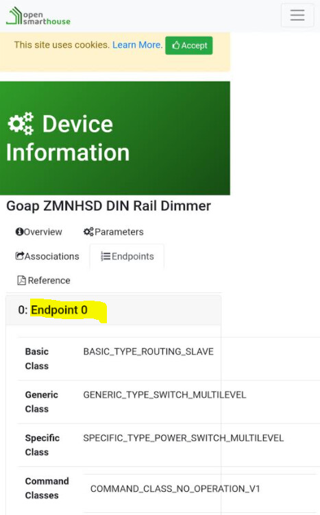

My question is: When I check the manual from Qubino it stated multiple endpoints for Associations while the ZWave DB only shows one. Could this be related to that and maybe can be solved with a different DB setting?

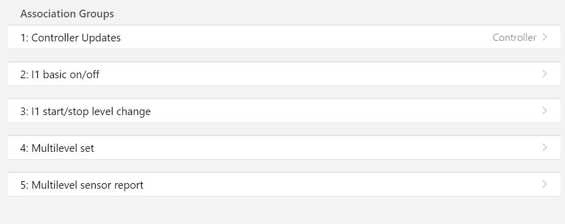

I tried the Groups 2,3,4 all without real success.

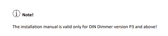

On their homepage they offer only a single manual for that device and unfortunately none for different versions.: https://qubino.com/manuals/DIN_Dimmer.pdf (page 35)
it does say however:
I also recall they did not even support the firmware update command class. So the only way for a new firmware would be to replace it (I have 16 of those. no good idea, 15 are P2 and 1 is P3 accroding to their “version” label on the device.)
How can I find out if maybe the older versions also have those endpoints and maybe just the earlier manual was wrong?
The earlier manual was probably correct for the earlier firmware versions. I am not sure Association Groups will be the solution you want anyway,
