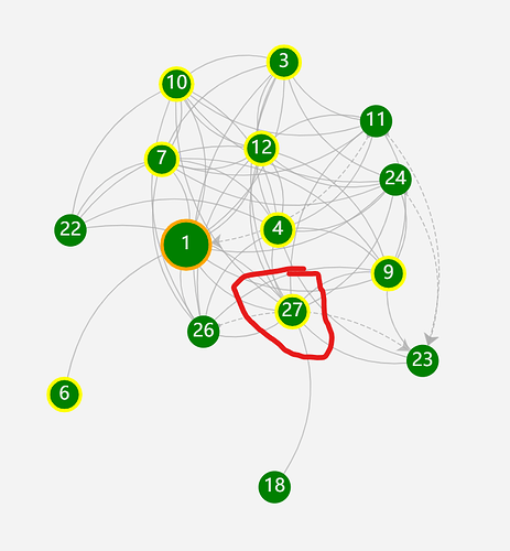

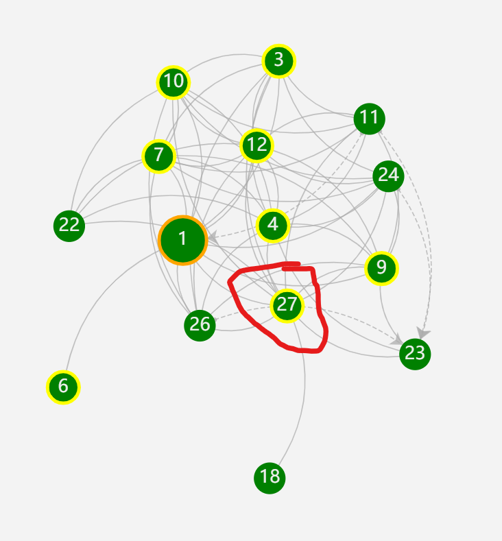

Just a quick one to the Range extender topic:
I just bought the version 7 of the aeotec range extender and the installation was easy.
However even though the node27 is correctly recognized and shown in mainUI things, it does not show up in the network map.
Does this take more than half a day?
After a few days it obviously popped up:
