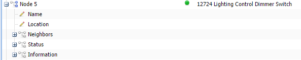

Great information, I was unaware of associations. I just read up on it and i guess i’m a little confused on how to set this up. I installed habmin and started following the instructions found here ( Z Wave Configuration · cdjackson/HABmin Wiki · GitHub ) but I do not see anywhere to add associations. When I follow the instruction this is as far as I can get. Am I missing something?
I have GE dimmers, I don’t remember the model numbers but I can find out. I know they’re the most recent version, at least they were when i bought them earlier this year.
I guess you have the GE12724? At least that’s what HABmin is showing in the image you posted :smile:
Unfortunately the GE devices don’t support associations - one of the few brands not to (for some very strange reason!). I think they send a NIF when you press the buttons though, and then the binding should treat this as a hail, and should poll at that point. Unfortunately the NIF is not routed since it’s a broadcasted message, so this will only work if the controller can hear frames from the devices directly.
