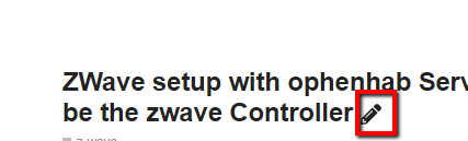

Click the pencil beside the post title.

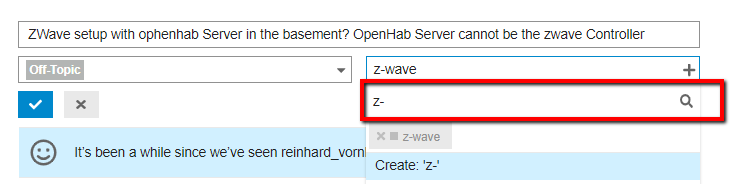

Click the + sign
In the search box type z- then click z-wave

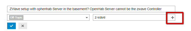

Click the + sign again and then click the check mark in the lower right of the images above.

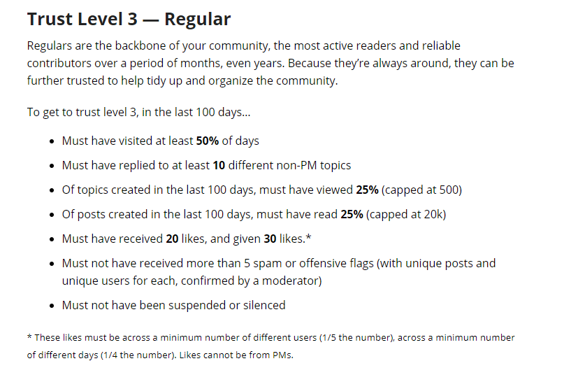

Would love to but I don’t have one of those pencil things… :roll_eyes:
Maybe some information here,
from Understanding Discourse Trust Levels
You’re forgiven. Keep hiding as long as you keep contributing :wink:
