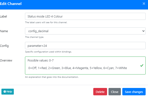

This can be handled with a ZW DB update. Read the blog on how to register and get write access. You will want to edit the configuration CC of your device to add a channel.

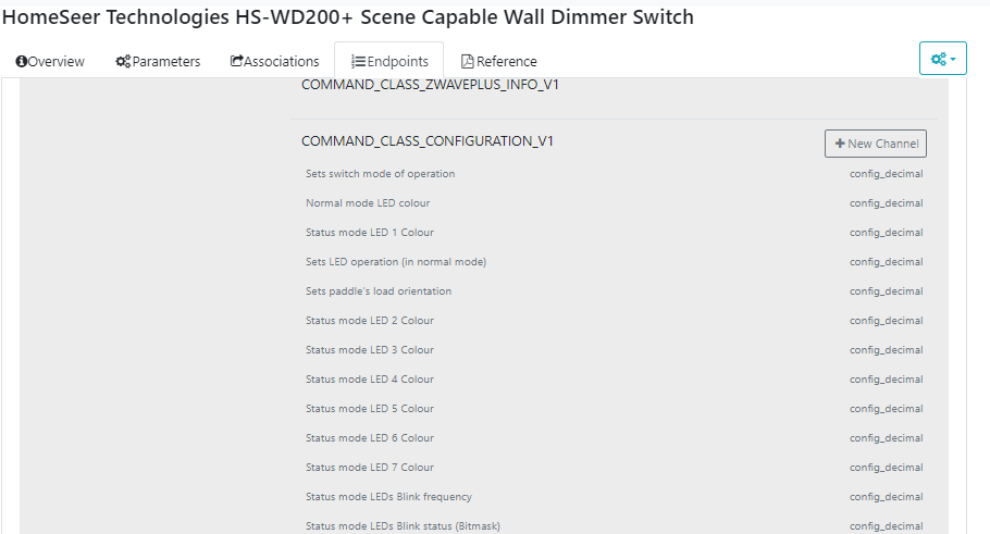

What model switch are you using? I’m able to link to status LED colors on HomeSeer WD200+ dimmers.
Number FoyerLed1Color "Foyer LED 1 Color" (gLed1Color) {channel="zwave:device:39d51d11b2:node65:config_decimal_param21"}
