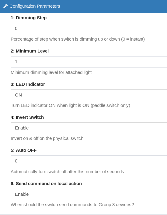

Sorry, but please can you say what is this trying to show, and what is it a copy of exactly?
This is a section of: /srv/openhab2-userdata/zwave/network_d57e8418__node_2.xml
Node 2 being the NZW39 in my system.
I’m assuming it is the section that 4 of the configuration parameters that show up in habmin:
Which goes on to list a total of 12 sections (6,6,6,7,8,9 not shown in this screen shot)
I’m trying to grok how someone got these based on what is shown in the inovelli github NZW39.xml.
As I said before, the Inovelli data might be wrong. Maybe there’s a manual somewhere with more parameters, or maybe the database is wrong.
Based on the fact that these entries are in the XML you pasted, it seems most likely that they do exist or they would not be in the XML. If you want to confirm this, then check the debug logs to see if there are responses to these parameters.
When I change the Dimming Step and save it in habmin reports in the log:
2018-09-15 12:42:23.362 [vent.ConfigStatusInfoEvent] - ConfigStatusInfo [configStatusMessages=[ConfigStatusMessage [parameterName=config_1_1, type=PENDING, messageKey=null, arguments=null, message=null, statusCode=null]]]
But, habmin shows pending… and there is never a second entry in the log.

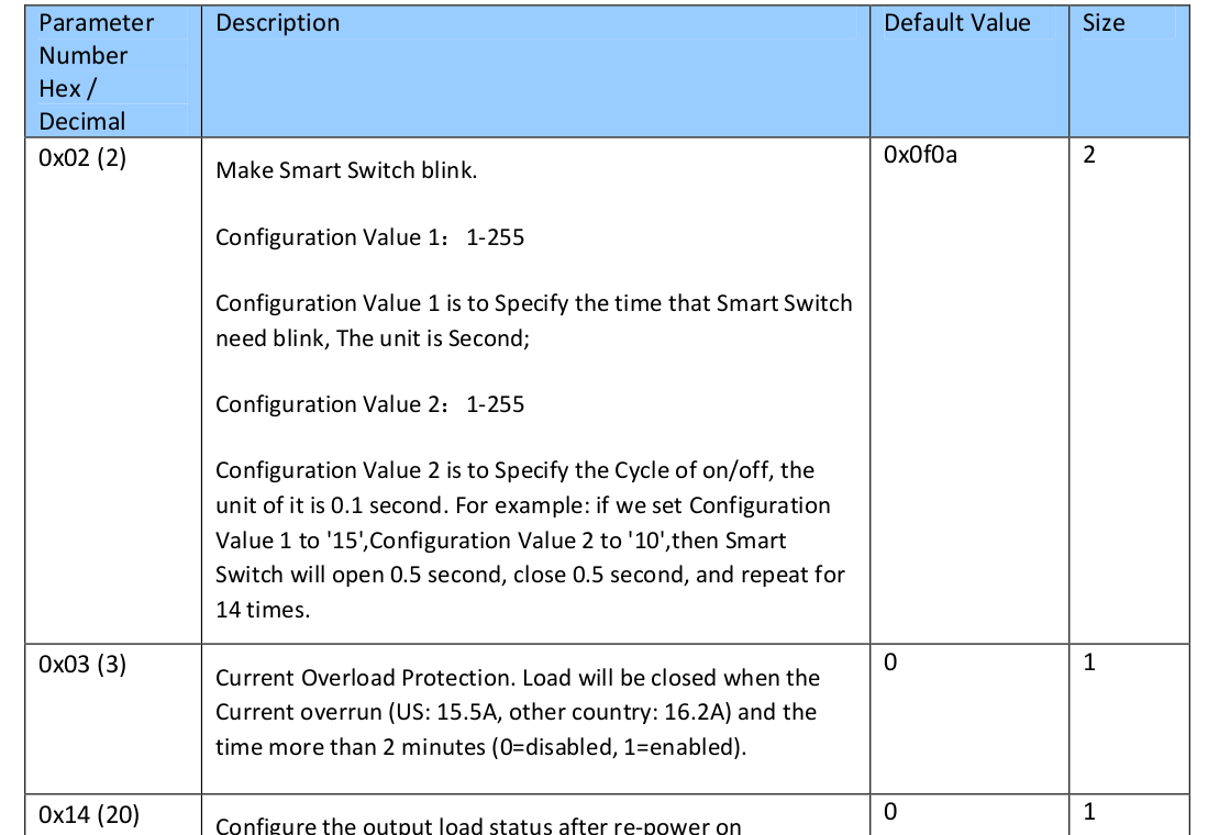

Yeah, I know those links. But, what I was asking for was a document, from a manufacturer I guess, that was the source for what I’d type in to create one of those by hand.
Maybe I’m making this harder than it is. Maybe what I’m looking for is what is referred to in the Database Guide page as reference material. I’m thinking the docs that are needed here are similar to the Aeotec engineering docs, for example: https://aeotec.freshdesk.com/helpdesk/attachments/6052990315
That have pages upon pages like this:
@5iver I suspect Inovelli may only be a rebranding house and have little knowledge about the guts of what they make…I could be wrong. When I did a failure analysis of a NZW39, fixed it, and sent them a failure report (I was a engineer in a destructive test lab in a past life…) they completely ignored it.
You will find similar info in other user manuals. An Aeotec HEM was one of my first devices, and their documentation spoiled me. The Linear docs are pretty good too, as in complete. From what I’ve seen, this information is rarely provided and usually needs to be reverse engineered. That’s one of the reasons Chris’ db is so handy, and not just for OH users.
Then you already have an example
. Every manufacturer provides the data in a different format - normally it’s in the manual, sometimes it’s in a technical or engineering manual, sometimes it’s in an XML format, and sometimes it just doesn’t exist.
If you are looking for a nice manual like the Aeotec one, for Innovelli, then I don’t think you will find one unfortunately.
SO, I got a reply from Innovelli:
For the NZW36 the configuration parameters shown in the XML (Parameter #1 & #2) are all that exist. On the newest version of the NZW36 there also exists:
Association group 2 (Basic_Set) which can hold 5 members. I will fix that for the open-zwave repository.
The device can also send a central scene report when you press the button 2x.
For the NZW39 the same is true. It has parameter 1 & 2 as listed in the XML file. On the newer versions of it there is also:
This certainly doesn’t match with what is shown for the NZW39’s I have. So, I went to one and changed parameter 4: Invert Switch 3: LED Indicator. I chose them since the action should be easily visible.
But, there was no change in the behavior of the plug.

Though I don’t know what to look for in the log to see if the change was accepted by the device, it does not appear to chage the behavior. (for example, set the led to always on)
BTW, is there a way to send specific commands to a device by hand? For example on my ISY944 there was a dialog that would allow me to specific the command code and payload to a device. I guess I’m asking if I can send or probe a zwave device from the OH console?
2018-09-18 09:01:34.592 [DEBUG] [tocol.commandclass.ZWaveCommandClass] - NODE 3: Received COMMAND_CLASS_CONFIGURATION V1 CONFIGURATIONCMD_REPORT
2018-09-18 09:01:34.594 [DEBUG] [class.ZWaveConfigurationCommandClass] - NODE 3: Node configuration report, parameter = 3, value = 1, size = 1
2018-09-18 09:01:34.596 [DEBUG] [ding.zwave.handler.ZWaveThingHandler] - NODE 3: Got an event from Z-Wave network: ZWaveConfigurationParameterEvent
2018-09-18 09:01:34.597 [DEBUG] [ding.zwave.handler.ZWaveThingHandler] - NODE 3: Got a value event from Z-Wave network, endpoint = 0, command class = COMMAND_CLASS_CONFIGURATION, value = org.openhab.binding.zwave.internal.protocol.ZWaveConfigurationParameter@e6b1ee
2018-09-18 09:01:34.599 [DEBUG] [ding.zwave.handler.ZWaveThingHandler] - NODE 3: Update CONFIGURATION 3/1 to 1
These lines show that parameter 3 was read from the device, and is currently set to 1, which is what you had set it to. It’s possible the device might need to be power cycled for the configuration change to take affect.
No, this is not available in OH. You can change configuration parameters by adding a channel for them in the device db. You can also send the command “REFRESH” to an item to poll the device and refresh the item’s state.
I guess it’s also possible that the configuration exists in software, but maybe doesn’t do anything? Sometime manufacturers use the same software/hardware for multiple devices as it makes it easier (ie cheaper!) for them to certify devices, but different versions may not have the same physical form, and (for example) may have different LEDs etc, or no power monitoring…
Just another possibility…
