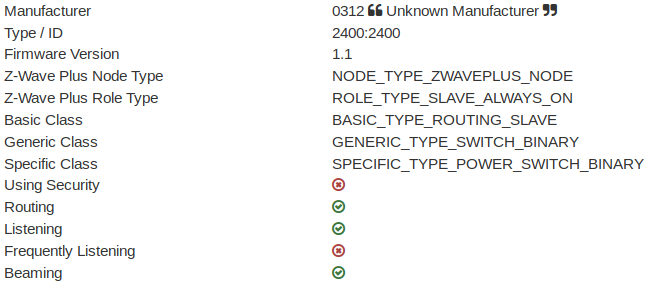

I also have added a NZW36 Smart Plug. It shows no configuration parameters and the folowing attributes:
This is a inovelli.

Also, I just added a brand new NZW36 and it shows 3 topics under Device Configuration and nothing under Configuration.
There is nothing defined in the database for configuration, so you might want to add those parameters:
https://www.cd-jackson.com/index.php/zwave/zwave-device-database/zwave-device-list/devicesummary/647
https://www.cd-jackson.com/index.php/zwave/zwave-device-database/zwave-device-list/devicesummary/831
I’m also wondering if those two devices should be combined, seems to be just different type and id’s, @chris what do you think? (Yes, I would have some spare time to do that :sunglasses:)
Yes - I agree. I’ve just deleted the older of the two as it had less information. I didn’t add the other device IDs to the newer entry though, so if you don’t mind, that would be great :slight_smile: .
Done.
I could not find any config parameters in the manual or the web. So I’m assuming there are no.
