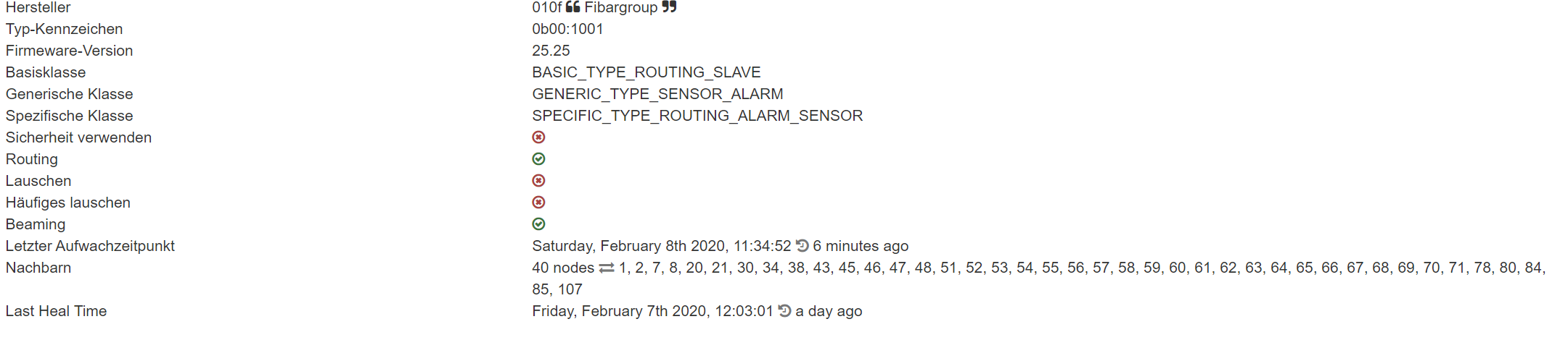

just to also show the vice versa effect I mentioned here is some event.log part
Node10 = Flood1 items
so e.g. you see the node updates some items at 4:51 just to be reported as offline at 4:53
and afterwards toggles between offline and online
of course this is no debug log and there could be non successful messages in the debug
however just from the timespan of 2 minutes between a successful message until its considered as offline looks unlikely

This is almost certainly caused by communications with the device timing out after 3 retries - this is another way that devices will be set to OFFLINE.
could be true for that device. this one was always troublesome with reception despite having 40 neighbors
