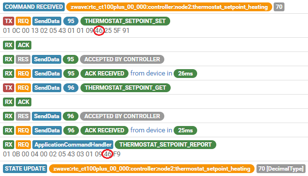

I’m new to OpenHAB, been reading a lot on the forums about installing and configuring my system- it’s been a ton of help, so thank you all.
I’m working with a CT100Plus thermostat, installed version 2.3.0.201803041016 of the Zwave binding. I’m communicating with the tstat, receiving updates, but can’t change the Heat Setpoint on the tstat through a sendCommand call in my rules. I have setup a proxy item design pattern (Design Pattern: Proxy Item - #6 by rlkoshak) and if the setpoint is changed on the tstat, everything works. However, if the update comes from the sitemap Setpoint item, the setpoint never changes on the tstat.
Here is my Zwave log of the transaction:

I double checked the operation- the zwave log was sitting idle, I changed the heat set point via BasicUI, log wen back idle. I didn’t see any response on the temperature. Here is that log: CT100 Plus Heat Setpoint.log.pdf (28.1 KB)
I tried the reverse, changing the set point on the tstat, here is that log: CT100 Plus Change Tstat.log.pdf (8.1 KB)
Interestingly, the first time I tried to change the set point on the device, it flashed my last change from the BasicUI (70), then flashed my manual change (66), then reverted to the original set point (65). I tried to reproduce this and couldn’t.
I still don’t see any problem. You are setting the temperature to 70 degrees, and the thermostat is reporting 70 degrees after the change -:
In the above log, the value 46 is the temperature (70 degrees in hex) - the SET command sets 70, and the report says the thermostat is set to 70… It looks fine to me from this at least.
Yes, Chris, you are absolutely correct- the internal heat set point on the tstat is changing and keeping the set point correctly (as evidenced by the log and confirmed through REST). However, the front panel display is not updating to reflect the change, hence my initial confusion as to why it wasn’t working. Thanks for tracking down the Zwave side of things and explaining what’s going on. I’m looking into other causes of why the tstat isn’t updating the display properly.
