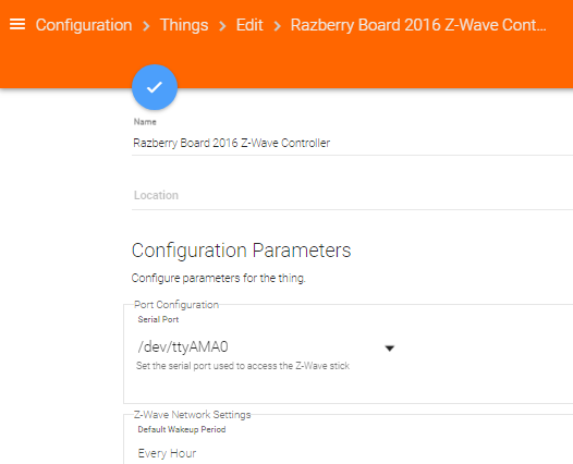

  • I configure the port:
  • I got “Server Internal Error” message:

Never seen that error, are you sure you have the correct port?
Check via dmesg | grep tty
did
sudo dmesg | grep tty
got
[ 0.000000] Kernel command line: 8250.nr_uarts=1 bcm2708_fb.fbwidth=1824 bcm2708_fb.fbheight=984 bcm2708_fb.fbdepth=16 bcm2708_fb.fbswap=1 vc_mem.mem_base=0x3f000000 vc_mem.mem_size=0x3f600000 dwc_otg.lpm_enable=0 console=tty1 root=PARTUUID=e9283127-02 rootfstype=ext4 elevator=deadline fsck.repair=yes rootwait
[ 0.000809] console [tty1] enabled
[ 0.894026] 3f201000.serial: ttyAMA0 at MMIO 0x3f201000 (irq = 87, base_baud = 0) is a PL011 rev2
[ 2.628378] systemd[1]: Created slice system-getty.slice.
Looks good, no more ideas.
Edit: Does your openhab user belong to tty group?
Yes, I added it to tty and dialout groups
