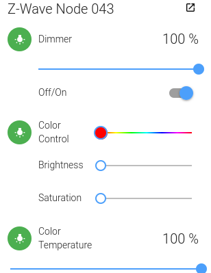

I’m using the default control on paperUi which looks like this for me :

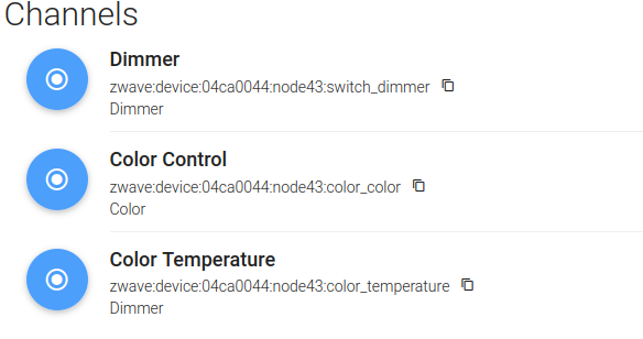

I can control the Dimmer and Color Temperature channels, it’s working OK. But When I try to use the color control, the color does not change. The light just switch off, here are my channels (I don’t know where is the conf file since I used only PaperUi for the moment. )

The Paper Ui is recommended only for administering OH. Use sitemaps and Basic UI or possibly HABPanel for daily operation.Parts of the Paper UI are broken and the original developer has abandoned it.

Looking at the database entry, the Color Temperature channel is to adjust the White color temperature.
The Color Control channel is for adjusting the RGB color values.
Yes, but I don’t how to use the channel color. I can control the Color Temperature channel but not the color control channel…
