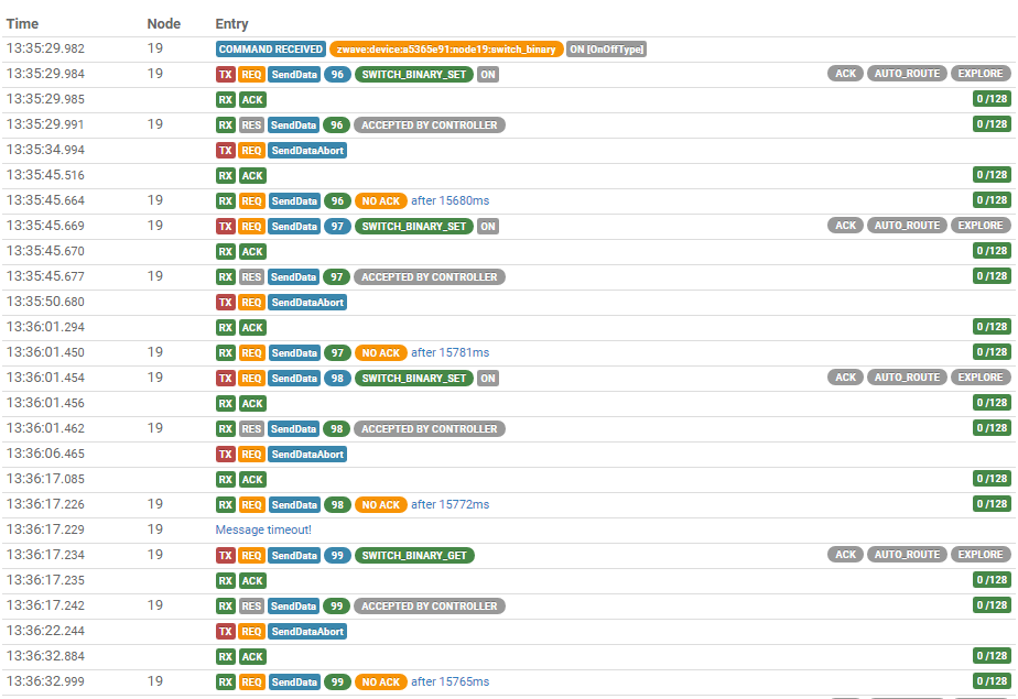

Still not helping me get this node online though. It seems to refuse to run through other nodes, and tried hitting the controller directly and struggling.

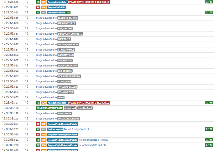

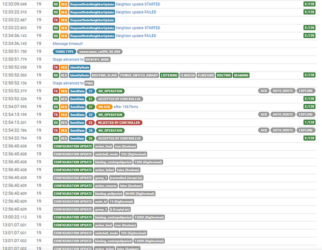

It’s showing as online now, but any attempt to heal or reinitialise or delete/add don’t seem to resolve it.
Can not start heal as initialisation is not complete (DELETE_SUC_ROUTES)
And I can’t force it to use an intermediary for routing. It’s almost like a need to drop its transmit power just a little, so it can’t see the controller directly.

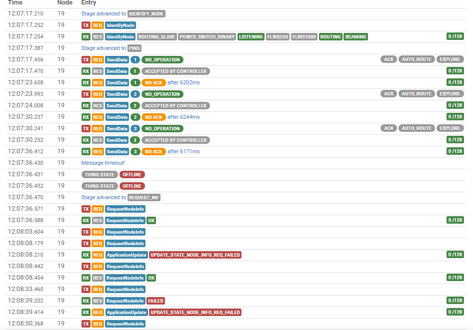

Have you looked in the debug log to see what is happening? Probably there’s an issue with the device not responding, but maybe it’s something else - the log should provide a lot of insight into what’s happening.
2.5.3 was released in March. Those devices in our database were updated early May. Please either upgrade openHAB or, at a minimum, update the Z-Wave binding.
So I updated to 2.5.6 today. No change to node 19.
I just see a lot of red for it. So this is from a restart. 19 was existing before the restart. But if I delete it and add it, no change. I have all this as a log file. Its 8mb. I’d been playing with moving the controller around, just trying to get it to pick up 19, but nothing seemed to help.
Ahh this time it’s actually completed figuring out what it is…but seems to be sitting offline…quite often does this. And then it might come back online in an hour or so, and so I’ll try to heal it to get a neighbour update.

so what i tend to see is that the device will send a meter report, openhad will class it as awake, until you try and send something to it, where it will go offline again.
From a quick look, it seems that the device is not responding - I see requests timing out and it looks like the device didn’t respond (which is normally what the timeout means).
Does the crow have to fly through walls?
8 meters is possibly getting a bit far potentially - it really depends on a lot of things - how many walls are in the way, what the walls are made of, what the devices are etc.
But isn’t that when it should run through other devices? It seems to think it can hit the controller directly. And noThing I do with placing smart switches within a few meters changes its routing.
This is an aeotec nano. Yes there are walls and even a floor between these controller and switch
