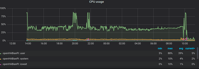

Replying to my own post. I have downgraded to M5 and the problem is gone. This confirms to me that this is not some problem with my system, but a problem in openhab. I will try to upgrade to M6 tomorrow and see if the problem reappears.
You didn’t mention the media OpenHAB is installed on on your Pi. Is it an SD card? If so, did you install both M5 and M6 on the same SD card? Your issue kind of sounds like maybe the card is going bad. The behaviour you describe is normal when a rule is saved. Is the Pi running on a separate drive? Maybe connection between the Pi and drive? Just guessing here
Hi, thanks. I use a fairly new ssd drive. I installed both M5 and M6 on the same drive, so nothing about the connection changed. I agree that the behaviour is similar to a rule being saved, but there is a differece. If I save a rule, I get the following lines in my log:

When I re-enable Hue Dimmer Switch, “java” goes to approx. 380% when issuing the top command! And the log is beginning to spam with hue events again!
Same symptom I experienced (180% cpu hog) , but not hue related I think. Had to revert back to M5.
I upgraded yesterday, in general, everything seems fine, but openhab2 process uses all cpu.
ui and rules are, understandably, very slow.
after reverting to m5 everything is fine again.
