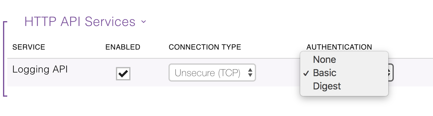

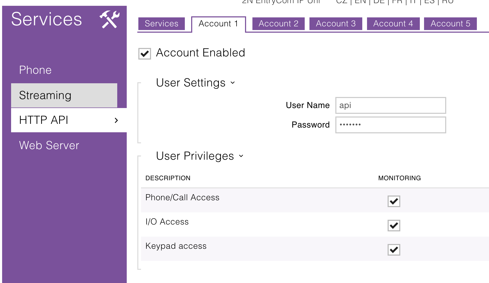

@kgoderis I did a test install of the binding for my Helios IP UNI - no license available for this one,
but as I understood the HTTP API / Logging is used which I should have available according to my config screen:
I guess this looks similar in IP Vario but you have more Privileges available?
Which user do I need to put in the thing configuration? The UserID of logging into the Web server or this HTTP API account (I tried both without success) ?
The binding seems to communicate with the Helios IP UNI as I can see the firmware and basic information within PaperUI, but I get communication errors with the following error message and the Thing goes offline (flipping somehow, flooding openhab2.log with this error).
2018-02-08 21:16:12.168 [ERROR] [ding.helios.handler.HeliosHandler221] - An error occurred while communicating with the Helios IP Vario 'helios:ipvario221:aac9498e': code '8', param 'null' : 'invalid authentication method'
2018-02-08 21:18:32.002 [ERROR] [ding.helios.handler.HeliosHandler221] - An exception occurred while processing an event : 'null'
	at org.openhab.binding.helios.handler.HeliosHandler221$3.run(HeliosHandler221.java:699) [251:org.openhab.binding.helios:2.3.0.201802061951]
	at java.util.concurrent.FutureTask.runAndReset(FutureTask.java:308) [?:?]
	at java.util.concurrent.ScheduledThreadPoolExecutor$ScheduledFutureTask.access$301(ScheduledThreadPoolExecutor.java:180) [?:?]
	at java.util.concurrent.ScheduledThreadPoolExecutor$ScheduledFutureTask.run(ScheduledThreadPoolExecutor.java:294) [?:?]
Which authentication method should be supported? Non, basic or digest?
It would really be great if the log information e.g. key pressed would also be available using the basic Logging API services without license.
