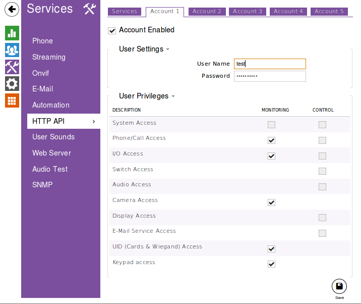

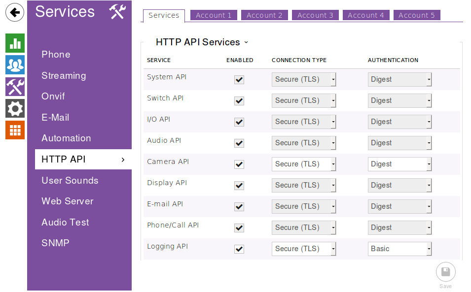

I tried too to insert my Helios IP Vario (without any special license) in my Openhab2 system with the Helios binding and this is what I found out:
1 - I set the Services-HTTP API section of my device in this way
and
2 - I decided to create a .thing configuration file, I copied the example from the documentation and I looked in the Paper UI to see if the Helios thing would appear, but the system could not find it. I tried with the automatic search and the thing was discovered, so I noticed a little problem in the thing configuration example of the documentation
Thing helios:ipvario213:gate [ipAddress=“192.168.0.14”, username=“test”, password=“**********”]
I changed it in this way (I deleted the word Thing at the beginning and I changed “ipvario213” with “ipvario221”)
helios:ipvario221:gate [ipAddress=“192.168.0.14”, username=“test”, password=“**********”]
and in this way my thing was recognized using the file configuration way too

@emme-oh You need to set “Basic” authentication instead of “Digest”

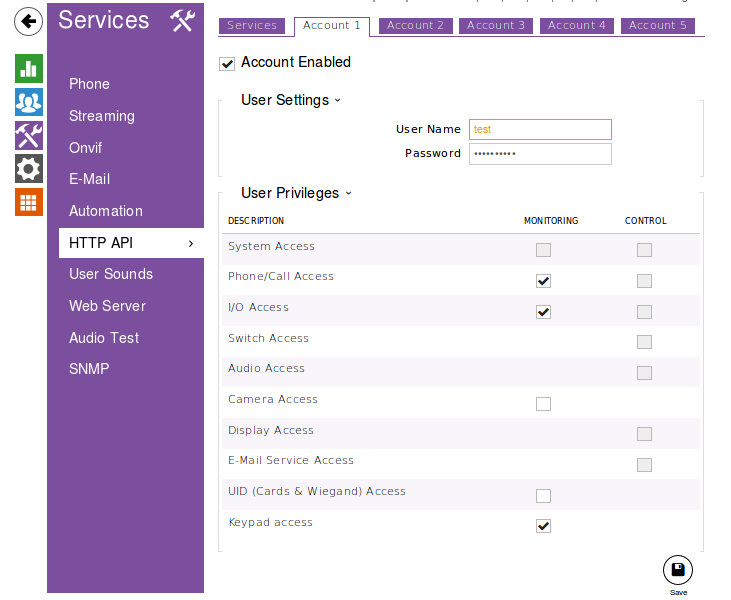

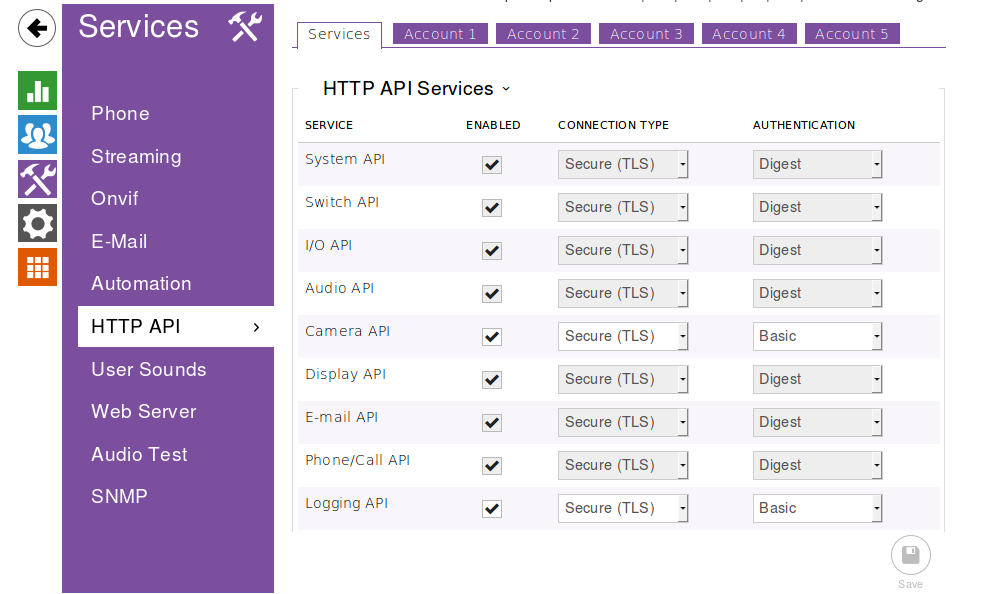

@kgoderis I had already set “Basic” before for the Logging API but I had left “Digest” for Camera API because my device hasn’t any camera.
Anyway now I’ve set “Basic” authentication both for Logging and Camera API (I can’t change anything else with my license)
and I added Camera and UID Access too to the user privileges even if my device doesn’t have those features (I can’t add anything else with my license)

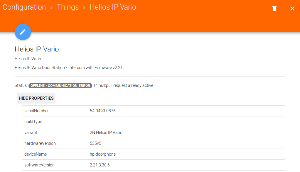

The result in the Paper UI is the same as before (Status: OFFLINE - COMMUNICATION_ERROR 8:null:invalid authentication method) and the log is this one

@emme-oh The reason it does not work in your case is that the binding needs “Basic” on the System API, which is the one I query in order to validate that it is a Helios device. Now, the weird thing is that this is the same API that is used to query or the serial number, HW version and so forth, so it could be that some part of the API is open for any authentication method. If so, then I have to rewrite part the binding in order to support other HW versions or licenses.

@emme-oh in the screenshot I do see another error (“pull request already active”). Can you provide me with more log data, preferably with the binding set to the TRACE logging level.
Tx
Hi @kgoderis,
yes, I do see the firmware, serial number etc within the paper UI (show properties). I activated DEBUG level. After creating the thing via PaperUI this happens:

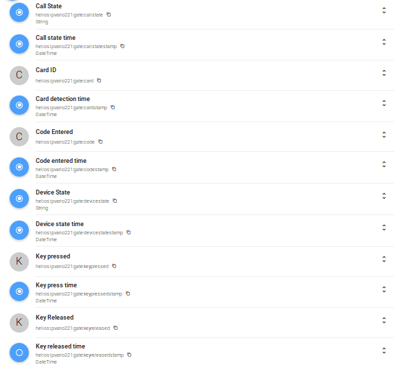

@kgoderis Hello, I tried too the last .jar file you sent and it works much better.
My Helios thing gets online and already I can use several channels, I set some items and they get information when some events happens.
In detail, this is what happens with my system:
  • the channels those do provide information to my items are keypressedstamp, keyreleasedstamp, callstate, callstatestamp, calldirection, switchstate, switchstateswitch, switchstateoriginator, switchstatestamp;
  • the channels those don’t provide information to my items are keypressed, keyreleased, all channels related to card (my Helios has no card reader), all channels related to code (my Helios has no keypad), all channels related to audiolooptest (my Helios has no Gold license), all channels related to motion (my Helios has no video camera), all channels related to noise and all channels related to devicestate.
Some of the channels those in my system doesn’t work appear gray in the PaperUI, as you can see in the attached screenshot
Considering that without Gold license my system can probably only get information from the Helios, I could say that the channels provided by this binding (once all of them will work) already cover all the useful information my system needs.

@kgoderis I just noticed that I had made a mistake in my item file, it affected the keyreleased and the keyreleasedstamp channel. Now that It has been corrected, the keyreleasedstamp works as expected but the keyreleased keeps on not working at all.
I’ll modify right now my previous message including this correction and the keypad misunderstanding one.
The channels those still don’t work, and I would expect to see working, are:
  • keypressed and keyreleased (the Openhab log file and the Helios event list provide information about them so I don’t think here exists any license issue);
  • devicestate and devicestatestamp (but i’ve seen the post where the state as reported by the device is described as silly :slight_smile: ).
Moreover, I don’t know if the channels noise and noisestamp can have chance to work with my (without Gold licence) device. Do have they?
