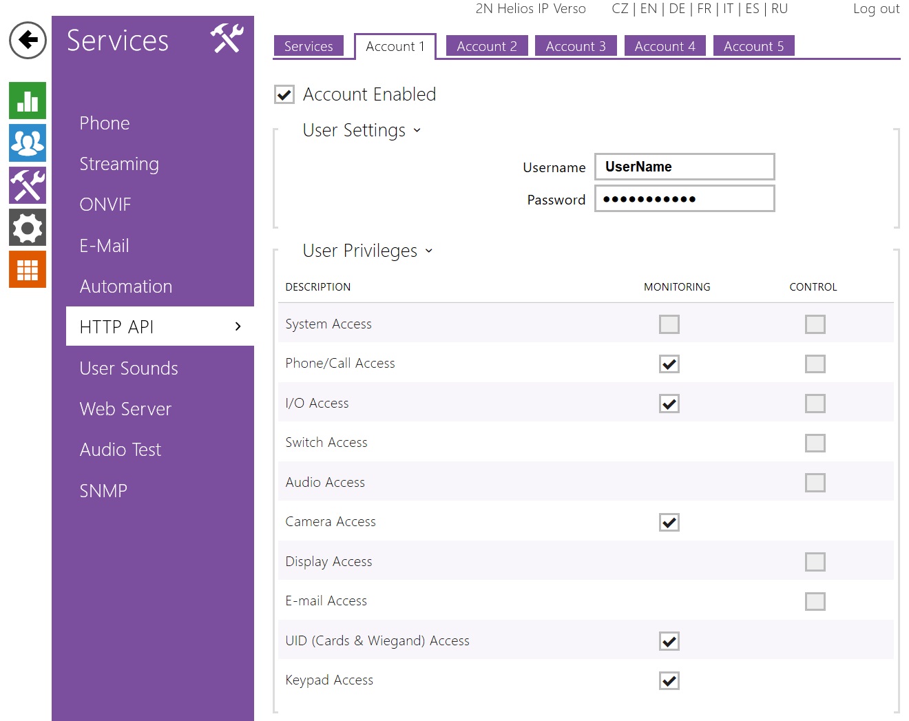

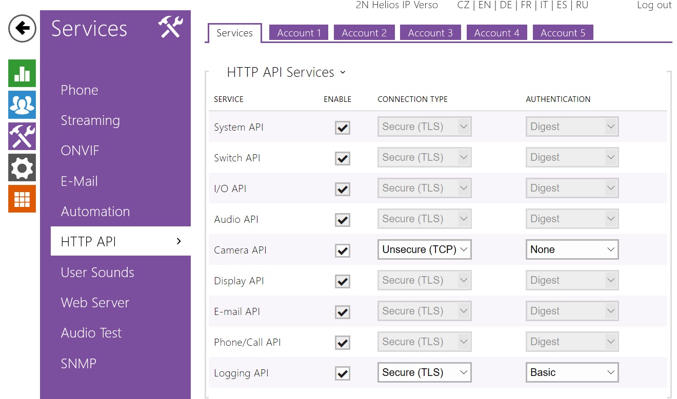

I have a 2N Helios IP Verso + Fingerprint Reader that I’ve been testing on (also got an IP Solo). I have no additional 2N Licences installed. Here is how I setup it up to get information into OH from the Helios IP Verso
  1. Setup the Helios (see pics) for the options
  2. In PaperUI, Add the “Helios” Binding, then in Inbox click on the “Helios” Binding and select “Helios IP Vario with Firmware v2.21” Put in the Authentication details and a bunch of channels got added.
For me the channels that are working are:
  • Call State
  • Switch State
  • Switch Number
  • Switch State Originator
  • Call State Time / Key Press Time / Key Release Time / Switch Switch Time. But they are all wrong. It looks like some offset from an Unix Epoch Time, eg for me it reads 19.01.1970 19:46:42.

All working well for me!
Thanks again for the binding and I hope the instructions above help.
Nathan

Good morning,
Has anyone here recently and successfully used this binding with a 2N IP Verso?
I am running into authentication issues. Initially, I could not get the Thing to start at all. After switching the device’s HTTP API from Digest authentication to Basic authentication, the Thing went online. However, I still see authentication errors in the logs, and the Thing channels do not seem to reflect any activity on the device, such as key presses.
Here is the relevant error message from the logs:
2026-06-07 08:17:24.874 [ERROR] [os.internal.handler.HeliosHandler221] - An error occurred while communicating with the Helios IP Vario 'helios:ipvario221:c2806bc9a7': code '9', param 'null' : 'authorization required'
Edit:
Since there are also error messages related to updating the Thing status (see below), I suspect that the Thing showing as Online is actually incorrect.
2026-06-07 08:30:34.267 [WARN ] [.core.thing.binding.BaseThingHandler] - Handler HeliosHandler221 tried updating the thing status although the handler was already disposed.
I also tried switching all HTTP API services on the Helios device to Unsecure (TCP), but that did not help either.
