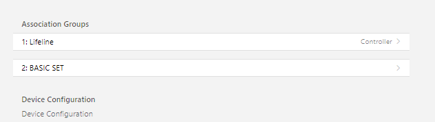

Well that is odd. Do the working devices show something like this on the UI page?
In any case I think the updated XML should fix the bad one.
EDIT: an easier first step might be to exclude the bad one and re-include. Maybe there was some variation in the inclusion process. The DB is not correct, but maybe somehow the device can override that.

Now all 3 devices show a new config section Association Groups with Lifeline: Controller (for the “bad” one I had to set that).
