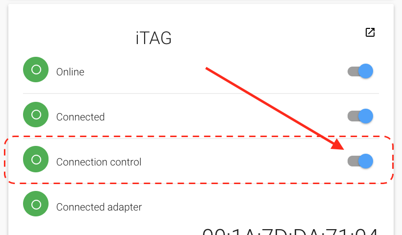

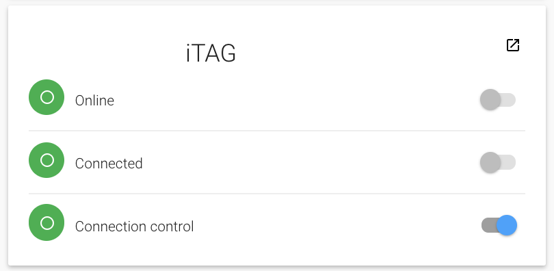

Hi @Celaeno1, please also make sure you have enabled the “connection control” channel like that:
Looks like there is a confusion around that. If this channel is enabled, only then the binding connects to device. This might need some thoughts around usability… Maybe for the “ble” type devices this should be enabled by default. But the thing is that you don’t want to enable connection for all your devices…

Hey @Celaeno1, you don’t have to enable “simple mode” and to do that awkward thing, you can link “connection control” manually. It is just yet another channel that is available to be linked as per normal.

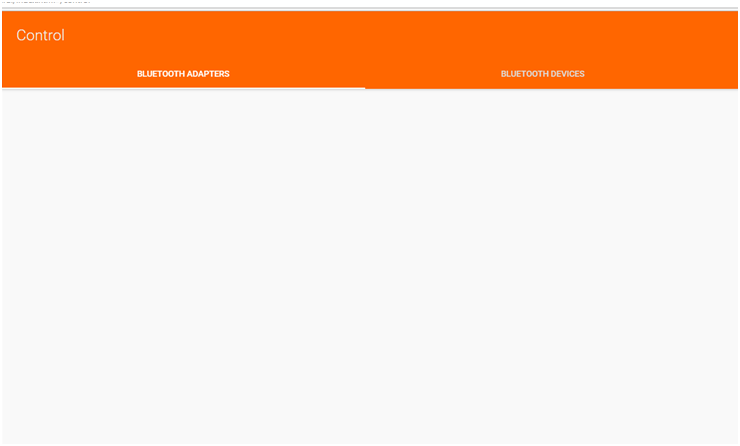

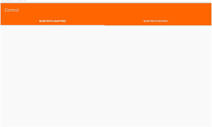

Maybe there is a missunderstanding? When “Simple Mode” is deactivated, then there will be NO thing to control, because NO items are linked to the channels.
As you can see, "BLUETOOTH DEVICES" is empty!

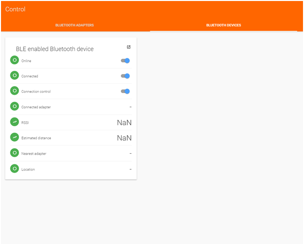

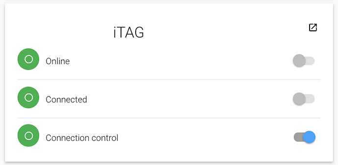

When “Simple Mode” is activated, then you can see the following:
And now, you are able to switch on: “Connection Control”. BTW, it is enabled by DEFAULT.
But this is only running with “Simple Mode”.

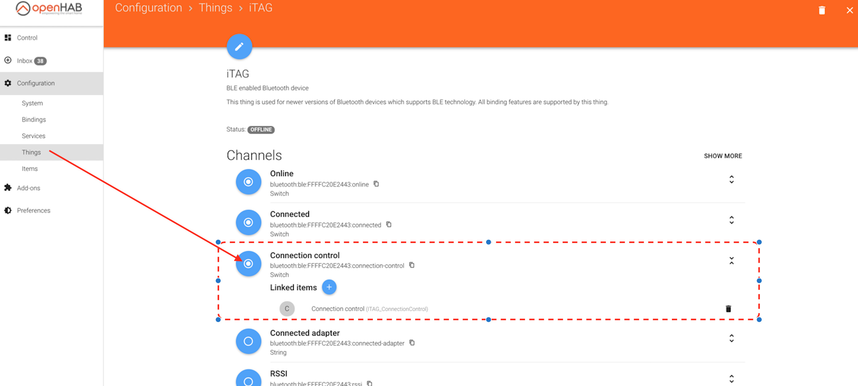

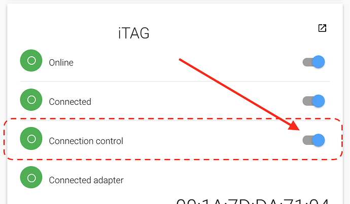

Hi @Celaeno1, you can manually create links here (when simple mode is enabled):
Click on that blue round dot, you may accept all default values. This is what you will get if you do this for “Connected” and “Connection Control” channels:
Please let me know if it is working for you.
I can confirm that iTag device working just great. I can see that button triggers a change in a characteristic, and also you can trigger a channel (it is hidden in the current version of the binding) to make the device to buzz!
