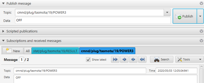

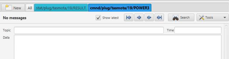

In my mqqt spy I receive only the result topics. I don’t receive anything listing to the cmd topic. But the switch is working:
When I publish the command in the mqqt spy I can also get it in the subscription:
So maybe my mqqt configuration is wrong in openhab for this plug?

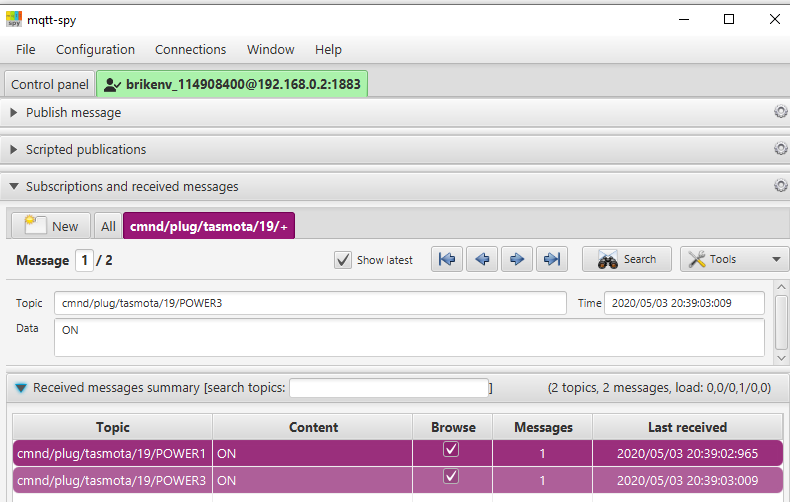

Okay I did try again and got the cmd this time.
I pressed only PlugT19_Switch3 to ON and received:
So the plug behaves correct to turn socket 1 and 3 to ON because there are actually 2 cmds.
So there is an error in my Thing or Item configuration which I didn’t change since my first post here.
