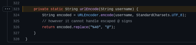

I think the issue comes from the URL encoding in the Heos binding (@ is already not encoded):
Reading the Heos CLI specification makes it a bit unclear to me if only ‘%’, ‘=’ and ‘&’ needs to be URL encoded, or all special characters needs encoding…

I just installed the binding and found this thread when having the same issue. I have prepared a fix:
https://github.com/openhab/openhab-addons/pull/19438
