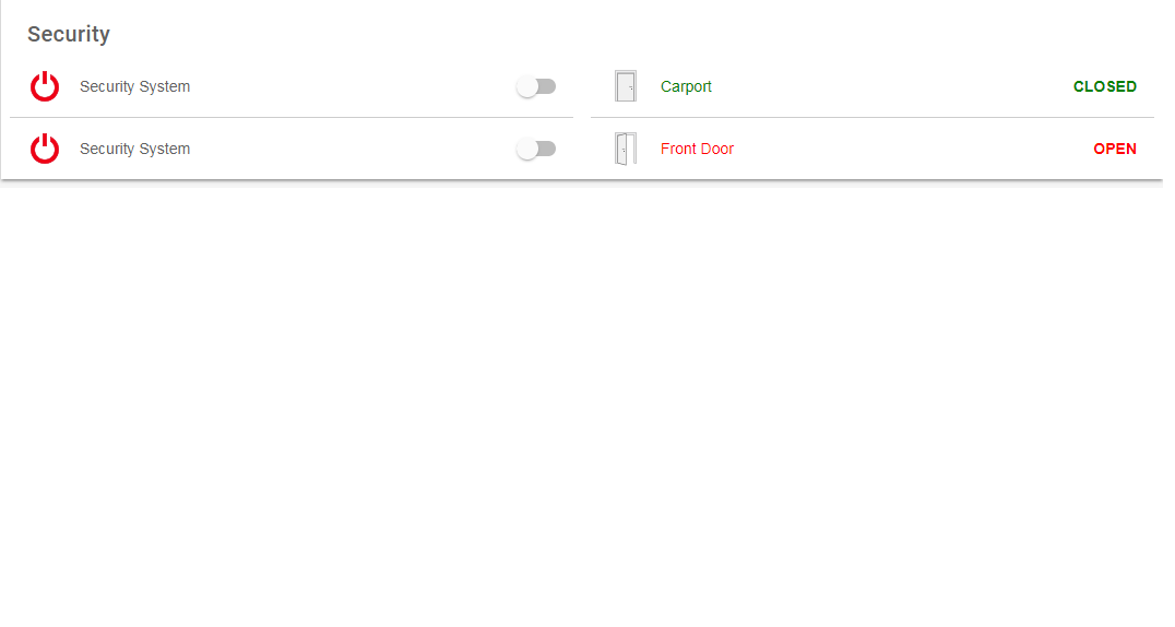

So here is a good working screen. Everything appears to be ok.
BUI%20OK
Here is what I’m working towards for the screen to look like if one of the sensors goes bad or possibly if the network goes down. Again future plans to have an indicator on the BUI.
BUI%20BAD
Is that what you needed?
John
You can have a look at this:
That monitors if sensors are alive
Then you can change the colour of the text in the BasicUI according to the state of an item
See:
https://www.openhab.org/docs/configuration/sitemaps.html#dynamic-sitemaps
