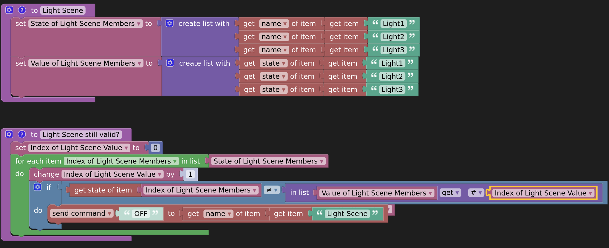

It seems that Blockly still writes in ECMAScript 5.1? When I start a new script with Blockly, I have no choice:
Or do I have to change some setting?
