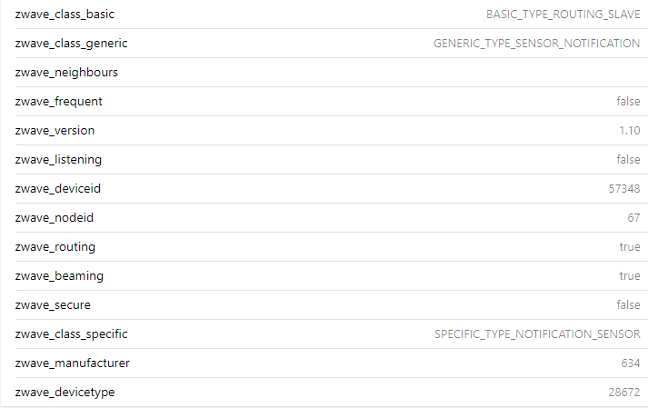

I’m trying to add a Zooz ZSE44 to my OH 3.2 system. The device is not in the database, so I need to collect the XML for it. Where is the xml? I looked in /var/lib/openhab/zwave and I see all the other nodes, but not the new one. Yet OH seems to know about it as I can see from the MainUI. Is there another way to get the XML so I can add it to the database? OH shows the device as “Online”.
NODE 67: Device discovery could not resolve to a thingType! 027A:7000:E004::1.10
Is there something I’m missing? Or should I turn on debug mode and try to capture a log of the inclusion?
