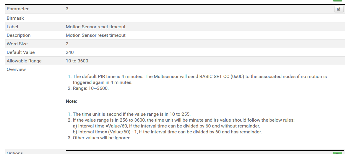

Adjust parameters for Multisensor 6
I’m using OH2 with the zwave binding 2.5.0. How are the parameters of the Multisensor6 adjusted? Parameter settings do not appear in either PaperUI or HABMin. I’m trying to set “parameter 3: Motion Sensor reset timeout”. The posts on the topic of the Multisensor6 motion sensor show shots of a parameter setting screen that the UI’s in my install don’t have.

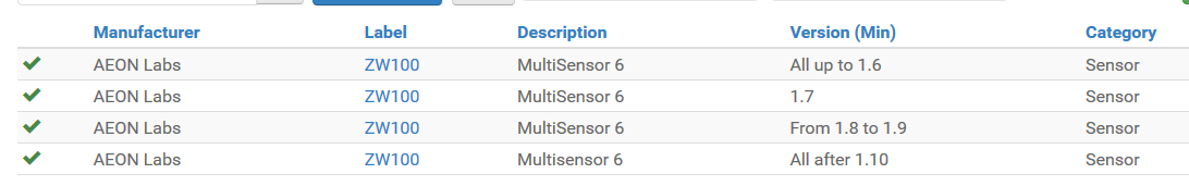

There are several sensors in the database, which one do you have`
Also please post your xml file.
I have 2 of these: v1.6 (running on Node 10) and v1.13 (running on Node 6). This is the Node 6 thing xml from /userdata/zwave:

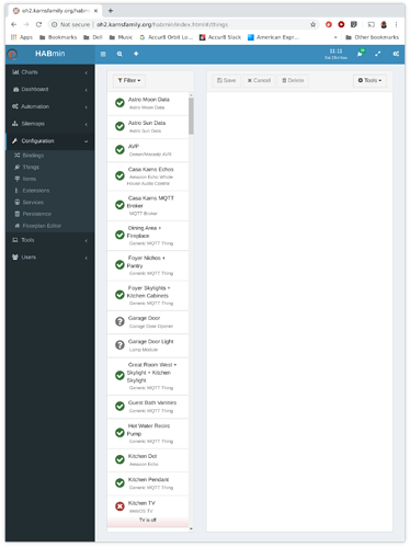

Also, when adding these after discovery using the zwave binding, I don’t recall being given a choice as to which firmware was on the Multisensor which would allow selecting one of the choices you point out when installing the thing.
This device has been in the database since about 18 month, including your device type and id and the parameter “Motion Sensor reset timeout”
https://www.cd-jackson.com/index.php/zwave/zwave-device-database/zwave-device-list/devicesummary/778
That parameter is also present in your xml file. You should be able to change the parameters via HABmin
grafik

No, the binding will pick the correct database entry from this part of your xml:
<applicationVersion>1.13</applicationVersion>
OK - I see the version in my xml file (1.13). However, where is the menu item “Configuration Parameters” located in HABmin? I don’t see that in my HABmin.

In HABmin, left-click on Configuration, which shows a drop down list containing Things. Left-click on Things. You should now have a list of all of your openHAB Things in the second pane from the left in the HABmin window. Left-click on the Z-Wave Thing you want to configure. You should now have, in the third pane from the left, a list of configuration categories for your Thing, one of which is Configuration Parameters. Left-click on Configuration Parameters and you are presented with the list of device-specific settings that you can set for your Z-Wave device.
I’m on a Mac using Safari. When I click on Configuration in the left pane, I see the list of the Things. Clicking on a Thing populates the far right pane with a Description heading (with save, Cancel and Delete at the top). In the Description I see Properties, Channels an Attributes, but no ability to view parameters. Since this is in a browser, Im not sure what a left-click is doing.
Do you see a scrollbar on the right of that pane, something like this:
If you scroll down using that scrollbar, do you see the clickable text, Configuration Parameters?
By the way, my browser is Chrome running on a laptop that runs linux. If Safari is not showing everything, can you try Chrome?
Using Chrome and opening the localhost openhab, then HABmin, I was greeted with a directive to download Version 2.0.0 of HABmin. Without doing that first, the only categories in the right pane using Configuration/Thing/TheMultisensor are Description, Properties, Channels and Attributes - no Configuration Parameters. The download link is to a GitHub project which says “The HABmin code has moved to …/openhab-webui - this repo is kept for its history and is thus archived”. openhab-webui is another Github project. Is it necessary to build the UI from the GitHub project and then install it in OH2?
Not in my experience. If I understood you correctly, you are running openHAB on a Mac. How have you installed openHAB and what version is installed?
I followed the install instructions at openHAB on macOS | openHAB and installed Milestone 2.5.0 and then installed org.openhab.binding.zwave-2.5.0-SNAPSHOT.jar to get the database definitions for my devices.
I have never seen the behavior you described above in post 11:
Using Chrome and opening the localhost openhab, then HABmin, I was greeted with a directive to download Version 2.0.0 of HABmin. Without doing that first, the only categories in the right pane using Configuration/Thing/TheMultisensor are Description, Properties, Channels and Attributes - no Configuration Parameters…
That makes me think HABmin may not be installed on your system. How did you configure your openHAB install? I use a configuration file, addons.cfg, that I think would be located in ~openhab/conf/services/ for your installation. In particular, the line (with preceding comment) in addons.cfg that specifies the UIs I have installed on my system is:

[Update: You can easily check on the UIs installed on your system by navigating to http://<your openHAB host IP address>:8080.]
It looks like HABmin is installed by going to http://<your openHAB host IP address>:8080 Using PaperUI/Add-ons/User Interfaces I see I have HABmin installed (along with other interfaces). I tried uninstalling HABmin using Paper UI and the process hung in the browser (HA2 is still running).but after refreshing the browser the uninstall seems to have worked. I then re-installed HABmin and still no Configuration Parameters showing up in HABmin’s Configuration/mymultisensor6
That is very strange. What version+build of HABmin is shown in the main part of the window when you click on HABmin from http://<your openHAB host IP address>:8080?
Following is a set of screenshots from the top of HABmin through to Configuration Parameters for one of my ZW100 multisensors. You don’t see a scrollbar on the right side of HABmin’s main window when you click on Configuration/Things and select your multisensor Thing? I have occasionally experienced strange behavior with HABmin’s display when trying to set the Z-Wave binding into discovery mode. You might try vertically resizing your browser window to force the need for a scrollbar.
I’m at a real loss for an explanation of what you are seeing there.
