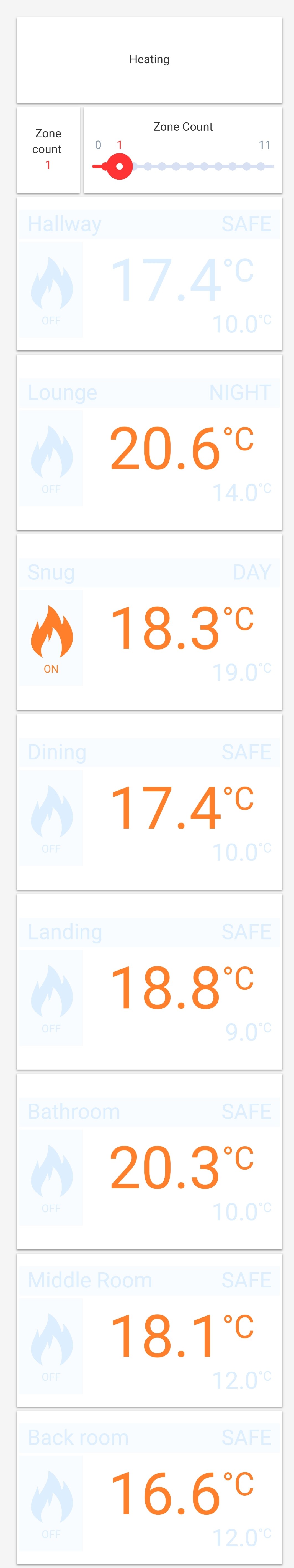

Using openHAB, you can create whatever UI you want.
I’m not a very good graphics designer, so my UI is very simple.
Some of my clients have created amazing interfaces.
FYI
I use a widget that @tomvancutsem created.
