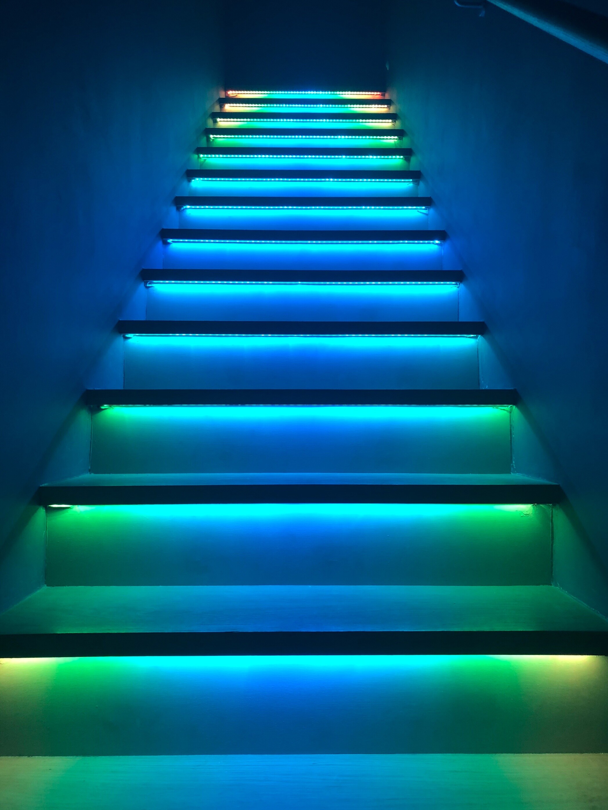

Hi
If it helps anyone…
I’ve just installed one of these SmartShow NetDMX dongles for a client to control his garden washlights from OpenHab2.
SmartShow NetDMX (UK Seller)
https://www.ebay.com/ulk/itm/272772662530
With 4 of these in 26 channel mode
https://m.thomann.de/gb/stairville_led_ip_bar_3208_rgb_dmx_ip65.htm
There are also 740 SPi pixels in his staircase, which are running from 2 x SmartShow Micro
https://www.ebay.co.uk/ulk/itm/273453456959
But to be honest, I’m using OpenHab2 to remotely control an ArtNet playback server called PixOut
