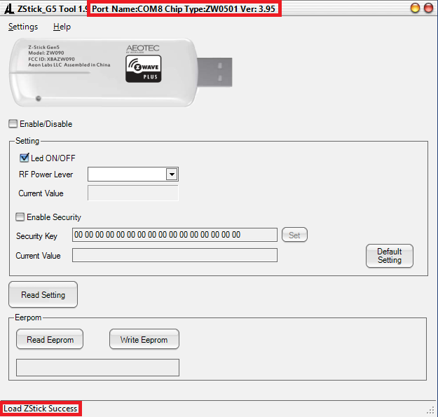

Please also check your Firmware Version, you can use the Z-Stick G5 Backup Tool.
If you also have “Ver: 3.95” (see the red rectangle at the top), this should be Firmware = v1.00.

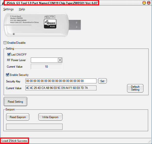

If your Firmware is v1.01 then you should see Ver: 4.54 (in the red rectangle).
P.S: If your Firmware is v1.02 then you should see Ver: 6.07 (in the red rectangle):
