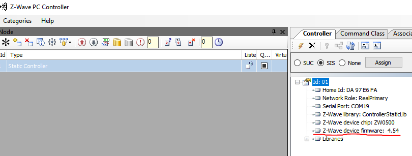

I also did further investigations:
According to the following data sheet there are the following firmware versions on the stick:
Version__ Name on Sticker___________ Firmware SDK API SmartStart RPi4 compatible____________________
Version 1 Z-Stick Gen5 1.00 v6.51.02 3.95 no Not without unpowered USB Adapter
Version 2 Z-Stick Gen5 1.01 v6.51.10 4.54 no Not without unpowered USB Adapter
Version 3 New Z-Stick Gen5 1.01 v6.51.10 4.54 no Yes, works without USB adapter
Version 4 Z-Stick Gen5+ 1.02 v6.81.06 6.07.00 yes Yes, works without USB adapter

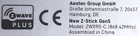

ZW090-C (EU Frequency)
Version 1:
Version 2:
Version 3:
Version 4:
unknown:
The firmware update mentioned above is intended for sticks with firmware 1.00 .
Mine is a “Z-Stick Gen5” (Version 3) with firmware 1.01 , like in this picture:
