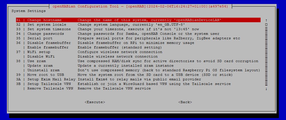

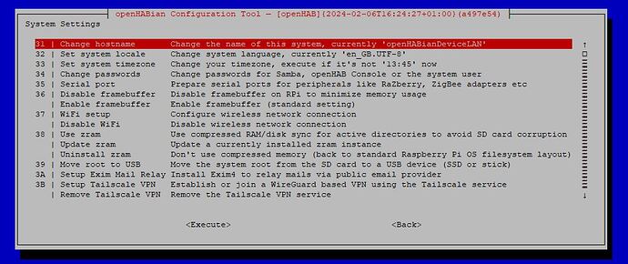

Option 55 (which is what your pic shows) exists to mirror internal SD to an external SD (not SSD).
53 is to setup permanent mirroring.
No as said I’m not picking up that ball again. Read what I linked to in my last post.

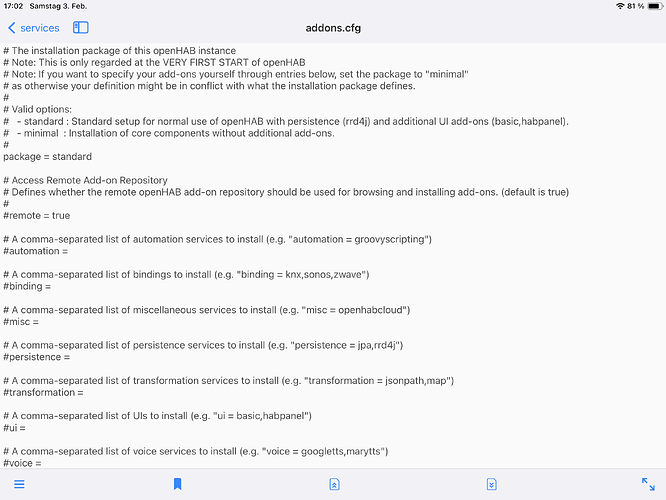

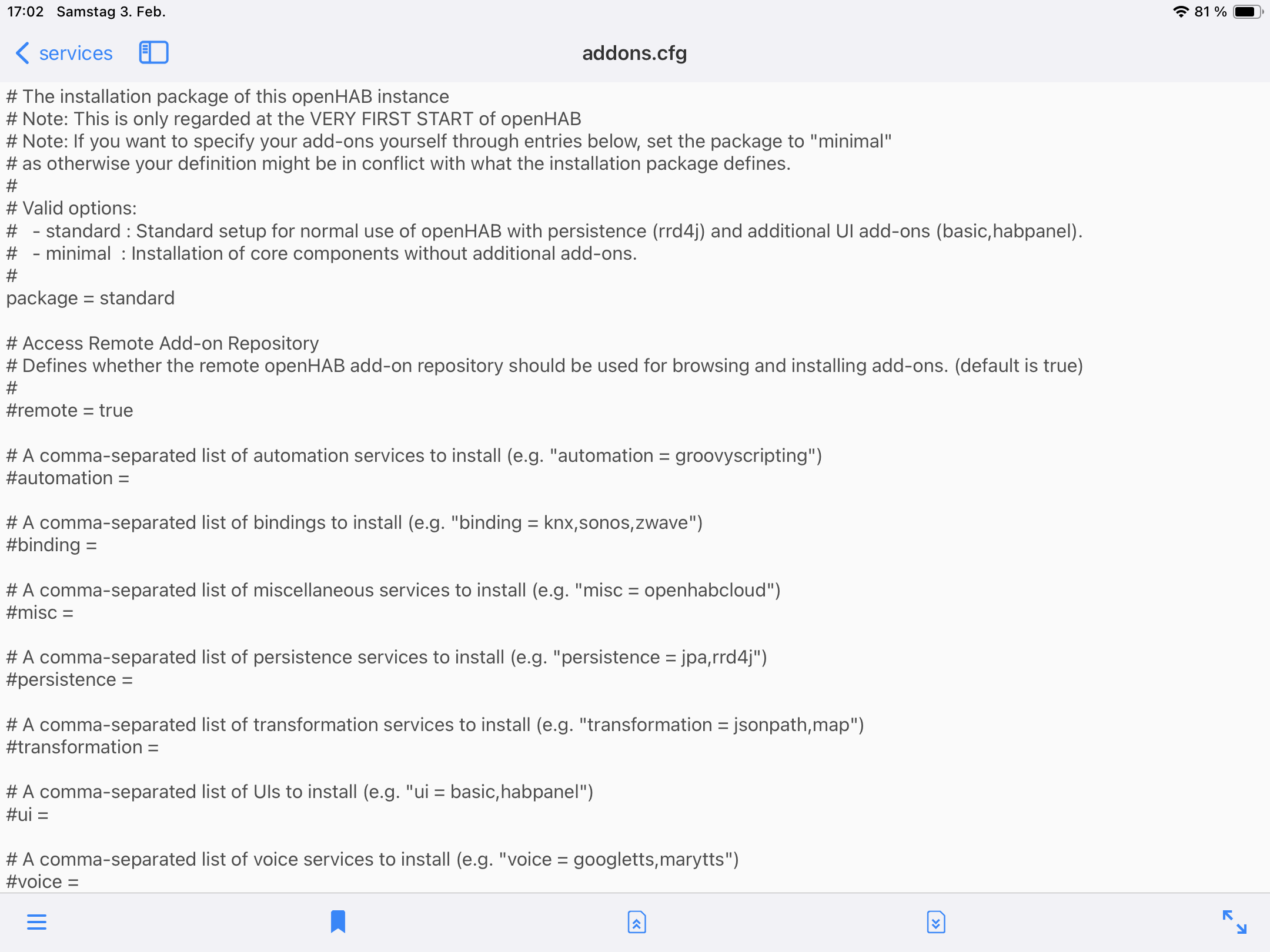

Underneath /etc
there aren’t any changes… see pic.
So I ask my self, where is the working .conf file?
Special solution for openhabian… not follow the guideline for all .conf- files in debian underneath /etc ?
Thank you

Last question about SSD:
for what is
39 “move” root to ssd?
Thank you for all helping hints

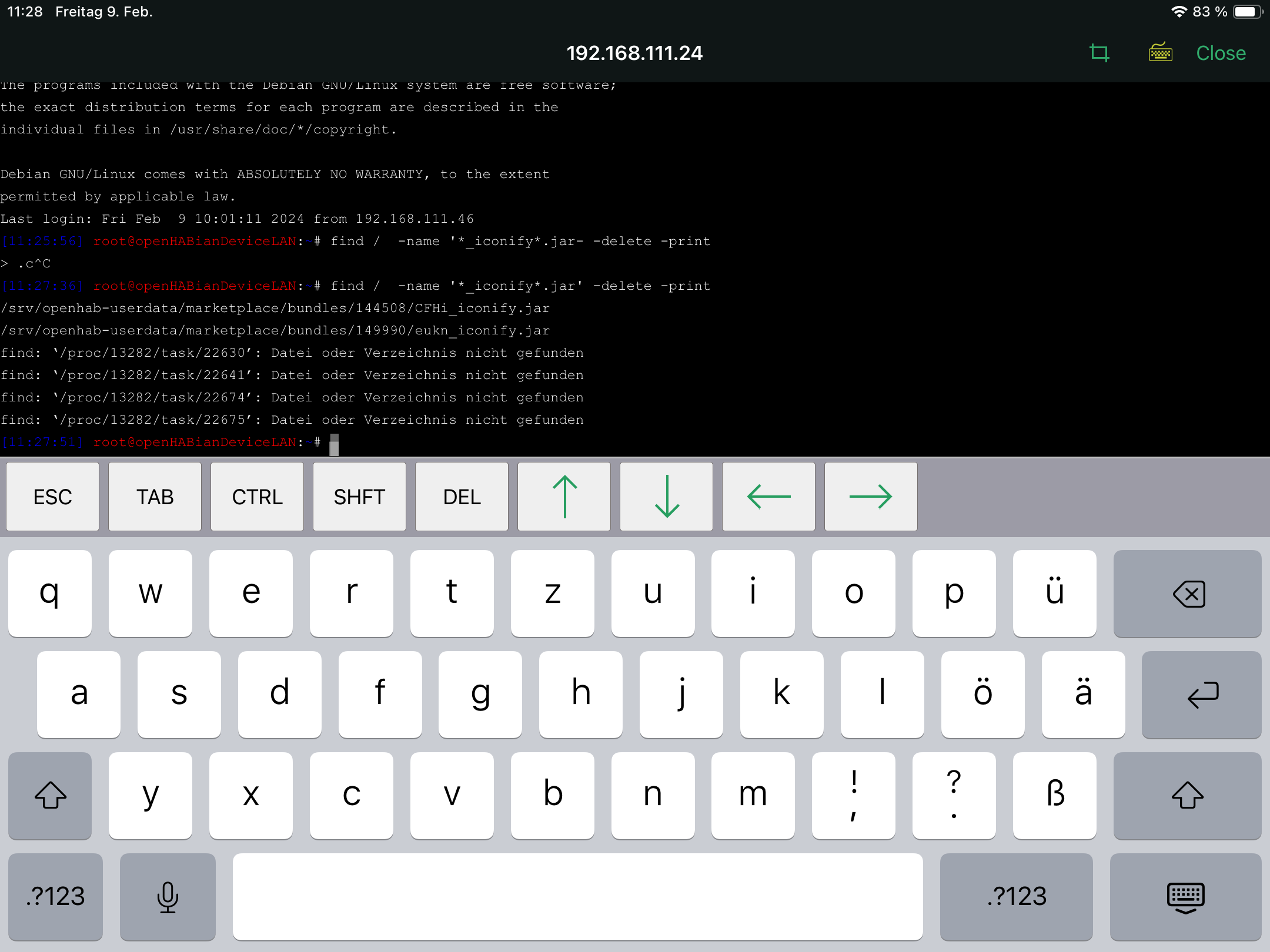

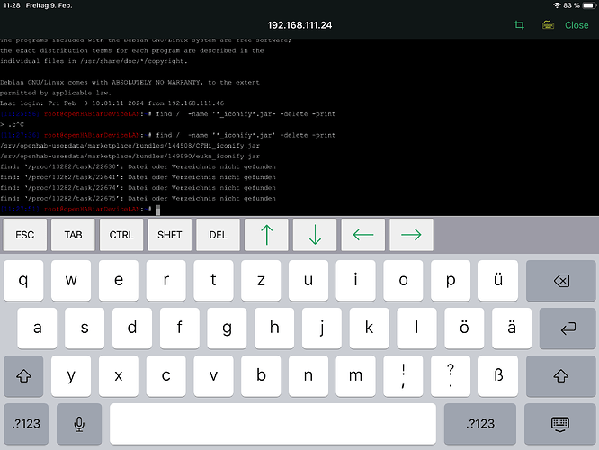

This is scanning of filesystem to see if iconify jar remains anywhere. You can obviously try other names. Do you remember how you installed iconify addon?
Hi, can you please explain more detailed the names issues?
How can I step in and correct “jsondb”? (Without UI!) Is there any database tool available?

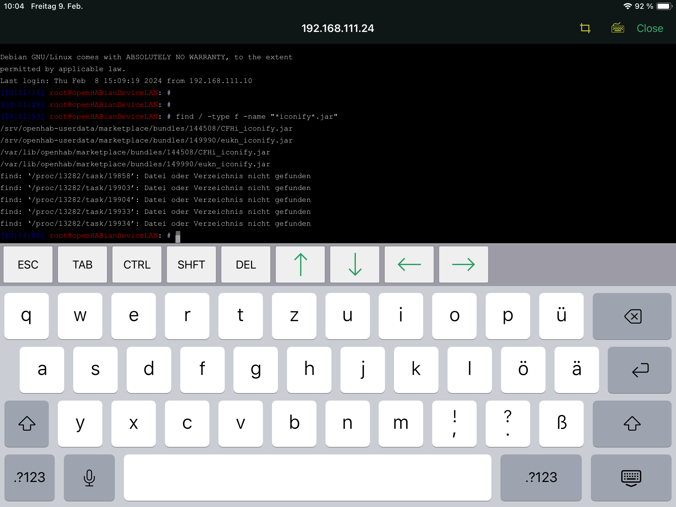

Here the result of the find job
Thank you
Takes 10 sec
[10:01:53] root@openHABianDeviceLAN:~# find / -type f -name “iconify.jar”
/srv/openhab-userdata/marketplace/bundles/144508/CFHi_iconify.jar
This will delete those files
find / -name '*_iconify.jar' -delete -print
May I ask why deleting them?
I will report what happen to the system (send the log)

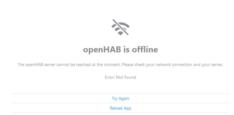

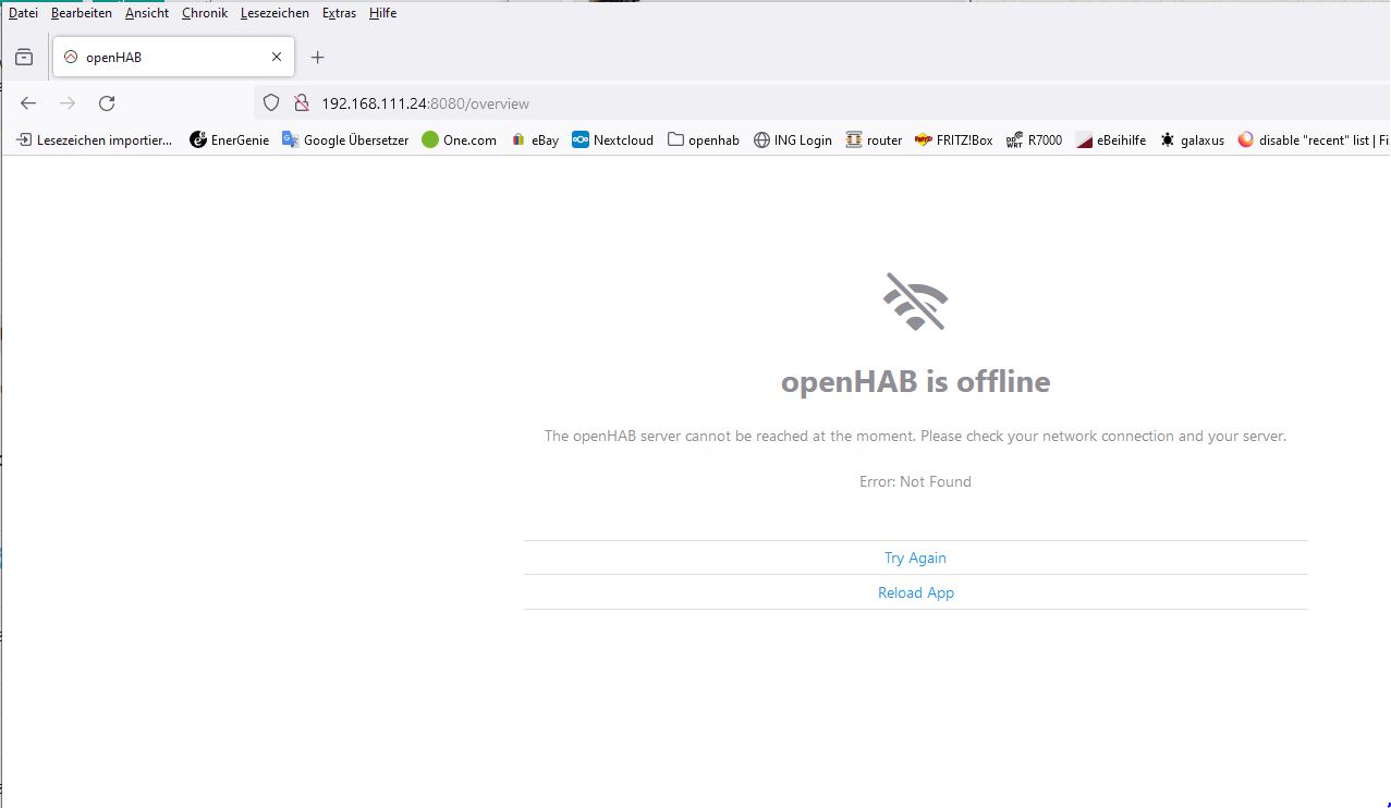

First start does not work
second start: here the log: (System restart by itself
after clear cache.txt (200.7 KB)
At the moment there is a UI …
But the system permanently start and stop HABPanel HABot → Basic UI!!! HUE etc → see

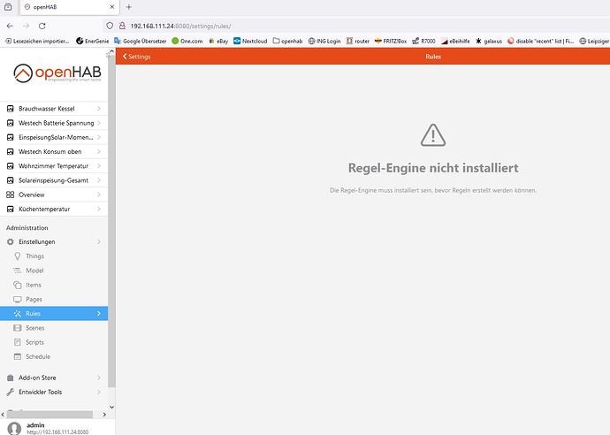

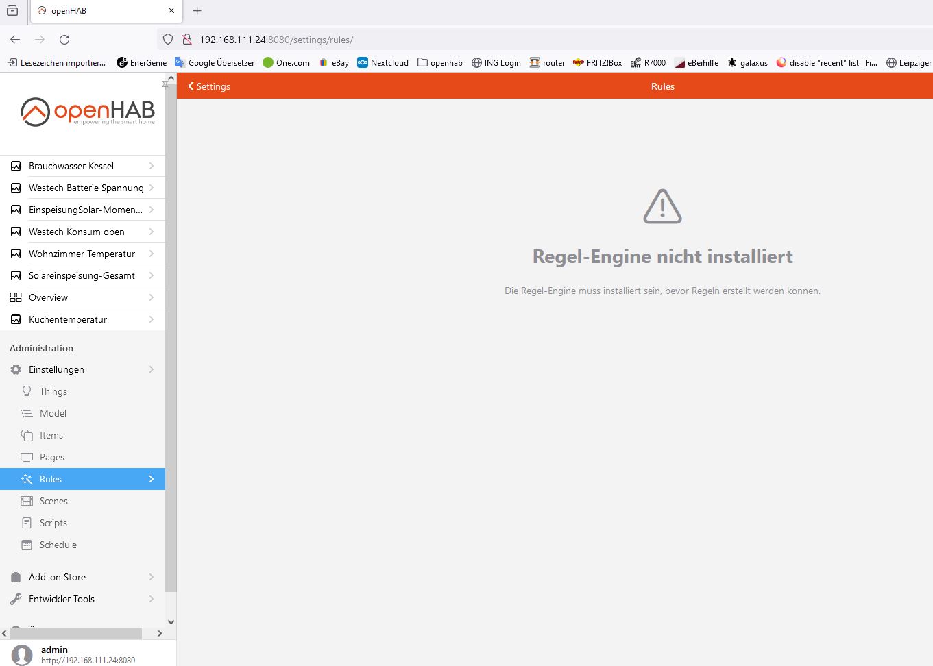

as espected:
after first login and having a look for installed bindings or rules:
So no improvement over all - the system is blowing in the wind a restore a backup which should be compatible to 4.0.0 as mstormi says (see above) does not work! Excellent "embedded backup and restore" solution! (As the whole!
After the fifth boot it´s up and runing… now I have problems with z-wave… some fibaro are gone or not operational… sinve 3. known
