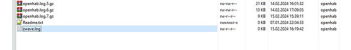

hi, I´m using a AEOTEC Z-Stick GEN5
I included in
/var/lib/openhab/etc
at the botton the lines you advised me:
log4j2.xml (6.4 KB)
but the log file :slight_smile: /var/log/openhab/zwave.log is empty
creation time is 16:19 today ist the time of the first service restart after changing the XML
So where is my fault that i didn´t get a log?

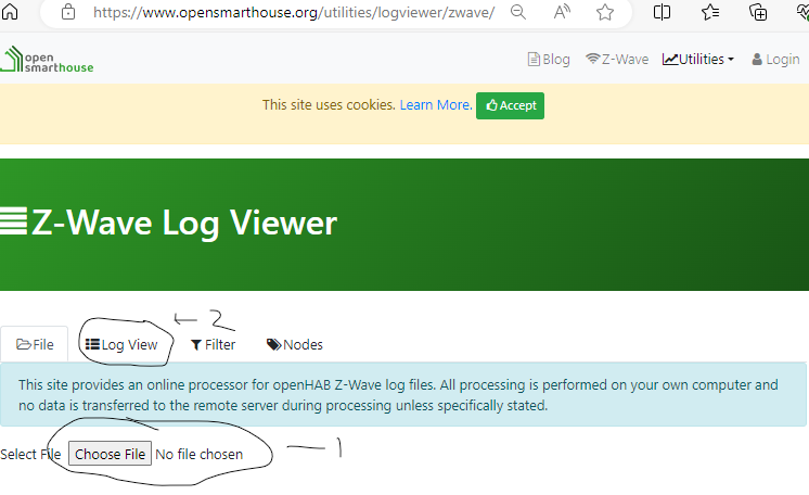

Sorry I did not undersstand what you mean by debug log viewer - can you explin what i should send?
Thank you
Cheers

		<!-- ZWAVE -->
		<Logger additivity="false" level="DEBUG" name="org.openhab.binding.zwave">
				<AppenderRef ref="ZWAVE"/>
		</Logger>

  1. Well, first we have to get some logs. (There has to be something if the nodes are showing online.)
  2. Two forks on the logs
    a) upload to this thread, so I can look at them
    b) on the self-help side, after clicking the link above you should be here: (1-add file, 2-log view)
