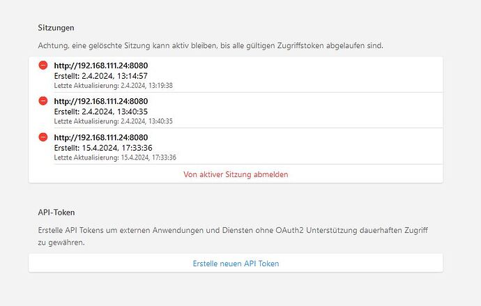

sessions weren´t close:
Sorry I didn´t report that i closed round about 100 sessions in 4.1.1 during the fix: after a while z-wave start working? Don´t know if it depends on the closings but I think for all others it should be reported!
