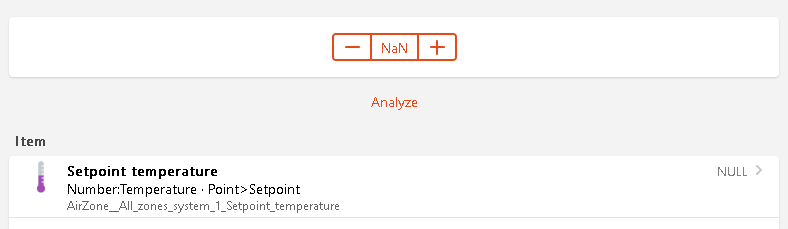

For the “All zones” item, this is what I get:
It’s quite expected because those items are “write only” and never get an update.
It is, however, impossible to use the + or - buttons here as NaN is not supported by MainUI. There’s nothing that I can do here, unfortunately.

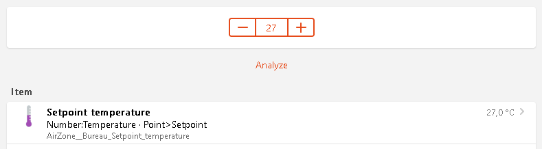

For other zones, this is what I get:
And it works just fine with the buttons.
Note however, that this value is only populated after a refresh cycle, so it’s possible to have the item for a valid zone stay at value NaN for a few seconds after creation. But once it has received an updated value, all should be fine.

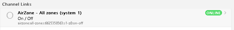

In all cases, you have to make sure the item is properly linked to a channel, as it may happen that openHAB “remembers” links from previous things and does not replace them with valid values.
The link should display online as seen here:

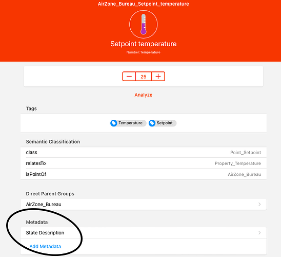

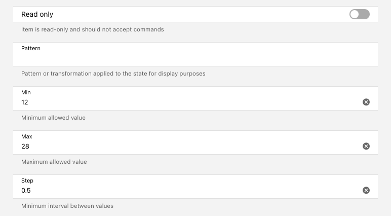

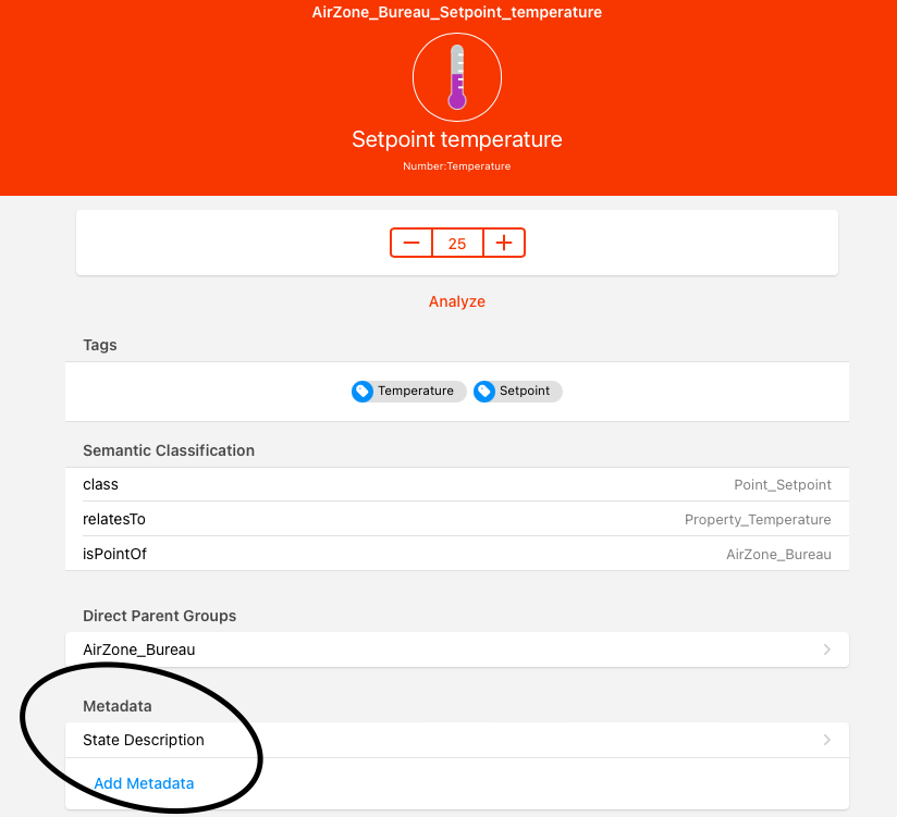

It’s up and running now! I had to include stateDescription metadata for each setpoint item, with a step value of 0.5.
Big thanks for your binding! I’m all set to use it for managing my system.

Would you care to show me where you did that?
I’m asking because the channel should already be defined with a step value of 0.5 so maybe I missed something.

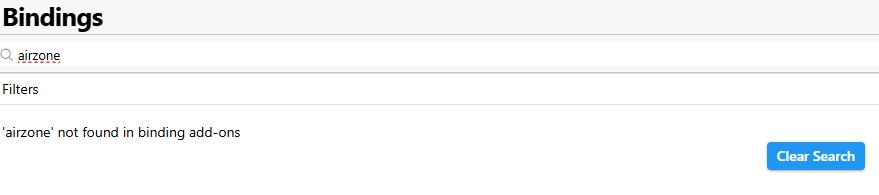

Good morning,
This week I wanted to install the Airzone binding, but it doesn’t appear.
Is this a temporary error, or has it been removed from openHAB?
I have several installations with Aidoo, and I’m concerned about having to modify the integration with openHAB.
Kind regards,
Which version of openHAB are you using?
If it’s version 5, then this behavior is expected as I have not yet had time to test the plugin with this new version of openHAB.
I’ll add this to my backlog, this should hopefully be sorted by the end of March.
