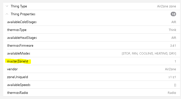

You can change it, but it’s only read/write on the Master zone whose id is indicated in the master_zoneID field. You can also see this value in a zone item properties:
Ah, I did not see that in the API documentation.
But then, how do I represent this in openHAB? I mean, I must have a value for a channel, but what is the value for “all zones” on each possible channel?
The same question goes also if you put all “setpoint” channels in an openHAB group. You can send a command to this group, but what is its value? This lead to quite a few debates here and the general consensus is that the group should not have a value, because each user may want something different.
Note that I’m not against having a “all zones” zone but I’m just voicing the issues I foresee to have a discussion before doing anything.
