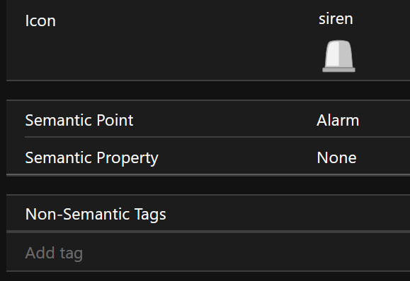

I noticed today that, after the item’s status was changed, it no longer appears.
This is my configuration, which has always worked with previous versions.
Even after adding the “Semantic Property” or changing it to “Semantic Equipment”, it still does not appear.
I also tried refreshing the page (Ctrl+F5), using different browsers, and even changing the status, but nothing worked.
items.getItem("Item123").postUpdate("OFF")
items.getItem("Item123").postUpdate("ON")

OK, based on what I see it should work. All I can recommend is to report the behavior on openhab-webui. Either the docs need to be updated, or there is a regression.
