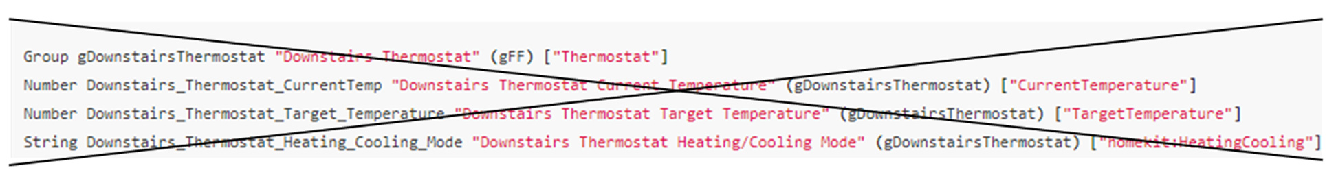

@antares2001
tag [ “Thermostat” ] is not supported with Hue Emulation.
Only tag [ “TargetTemperature” "] is supported. See here Link
Like this example:
Number  TestNumber4     "Temperature Set Point" [ "TargetTemperature" ] {channel="..."}
Not supported:

tag [ “CurrentTemperature” ] is not supported (with hueemulation).
Number	HEAT_DG_Kind	"Kinderzimmer Heizung [%.1f °C]"	<heating>	(gKind,gHeatingDG)	[ "TargetTemperature" ]
It looks OK, but your channel is missing… (but that’s not the problem!)
First of all, your device should be shown in Alexa App.
see also this topic: Link
Maybe you need to use tag [ “Themostat” ] but only the line [ “TargetTemperature” ] is running?
Group gDownstairsThermostat "Downstairs Thermostat" (gFF) [ "Thermostat" ]
Number DownstairsThermostatCurrentTemp "Downstairs Thermostat Current Temperature" (gDownstairsThermostat) [ "CurrentTemperature" ]
Number DownstairsThermostatTargetTemperature "Downstairs Thermostat Target Temperature" (gDownstairsThermostat) [ "TargetTemperature" ]
String DownstairsThermostatHeatingCoolingMode "Downstairs Thermostat Heating/Cooling Mode" (gDownstairsThermostat) [ "homekit:HeatingCoolingMode" ]
Then, you have to tell: “Alexa, set ‘Downstairs Thermostat’ to 20 degrees” (like in this example above!)
