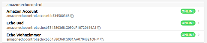

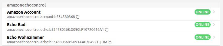

My first thought was that the entire binding is offline. But when the devices turn unresponsive, both the Things in openHAB are shown as “online” (both the account as well as the actual Echo Dot)…

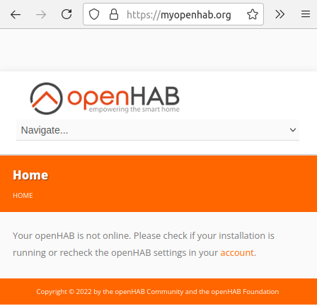

Logged into myopenhab.org (“Your openHAB is not online.”), so definitely a myopenHAB Cloud-problem? The Alexa skill can work without the myopenhab.org cloud, correct? If so, how is it possible that the Alexa commands reach openHAB, but appear to not be executed correctly (with a restart solving all this)?
No, it’s working for me. So the issue is in your connection to the cloud.
