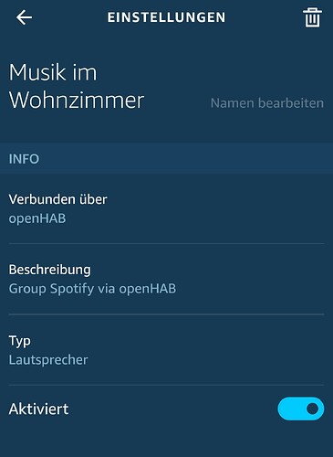

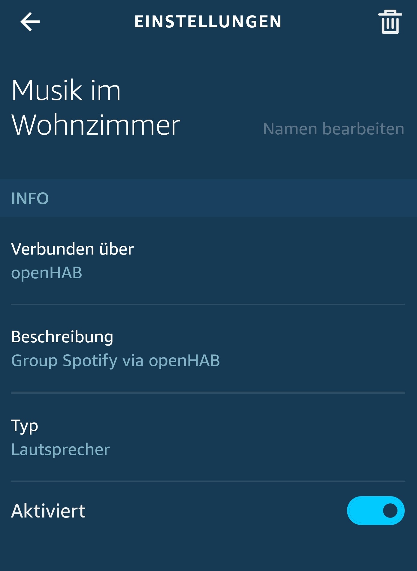

Would you be able to attach a screenshot of the Alexa group you set for your room keeping the TV device in it?
@orko If you have the time try using v2 tagging ( [ “Lighting” ] ) with the group and see if that changes anything.
Hi
I am not sure if the attached screenshots help you.
Hi
This is my configuration for the speaker:
Group Spotify “Musik im Wohnzimmer” (Entertainment) {alexa=“Endpoint.Speaker”}
Switch Spotify_LivingRoomPower “Musik im Wohnzimmer Power” (Spotify) {alexa=“PowerController.powerState” [category=“Speaker”]}
This for my lights:
Color LivingRoom_CeilingLamp “Wohnzimmer Deckenlampe” (LivingRoomLamps) [“Light”] {channel=“hue:0220:0017882a05d0:11:brightness”}
As you can see I don’t use Alexa to control my lights in openhab. On the Alexa side I use the Hue skill to control the lights. In the screenshots that I attached to another post you can see that the speaker is registered as Lautsprecher (speaker) in the Alexa app.
