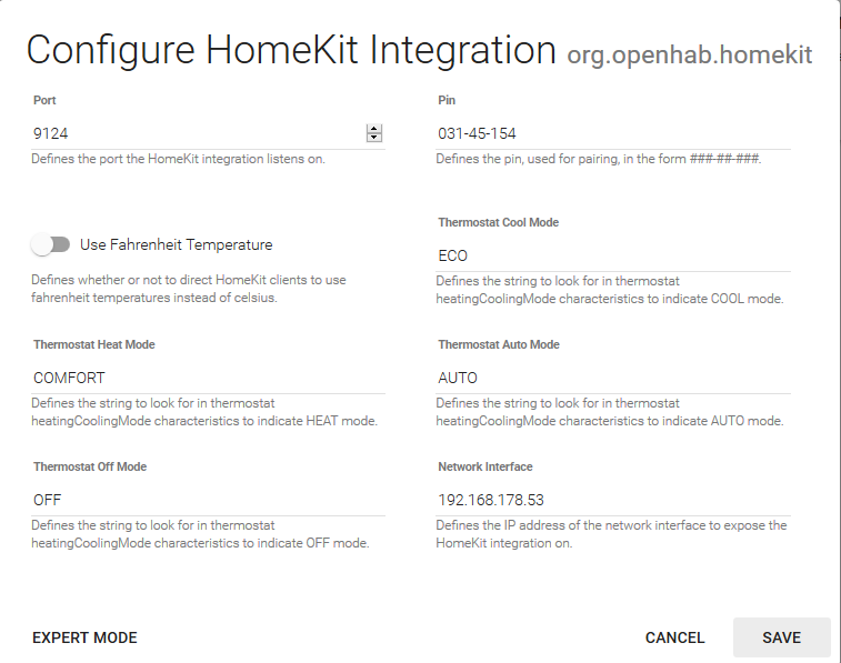

Did you look at the documentation for the homekit setup: http://docs.openhab.org/addons/ios/homekit/readme.html#item-configuration
There seem to be a third item - HeatingCoolingMode - which has to be added to the Group for your thermostat. Additionally there seem to be a configuration to customize the mapping of the different HeatingCoolingMode modes. Maybe that is the way to go. E.g.:
demo.items
String BadThermostatHeatingCoolingMode "Badezimmerheizung Modus" (BadThermostat) ["homekit:HeatingCoolingMode "]{channel="avmfritz:Comet_DECT:192_168_178_1:119600066888:radiator_mode"}
demo.cfg
org.openhab.homekit:thermostatCoolMode=ECO
org.openhab.homekit:thermostatHeatMode=COMFORT
org.openhab.homekit:thermostatAutoMode=AUTO
org.openhab.homekit:thermostatOffMode=OFF
Be aware of typos. I wrote this down in a second.

String BadThermostatHeatingCoolingMode "Badezimmerheizung Modus" (BadThermostat) ["homekit:HeatingCoolingMode ** "]{channel="avmfritz:Comet_DECT:192_168_178_1:119600066888:radiator_mode"}
Now I can also Ask: “Alexa how is Bathroom Heater set to?” in German: “Alexa, wie ist die Einstellung der Badezimmerheizung?”
Alexa answer: “Unkown Modus is set to xx°” ← Means the currently set degrees
BTW also if I say “Alexa, set Bathroom Heater to xx°”
Alexa is answering “Unknown Modus is set to xx°” ← Means the new/adjust degrees
It is not very pretty, that the Mode is unknown for Alexa - but it works! Has anybody new experiences to teach Alexa, what “unkown modus” is?
My configuration of Homekit:
