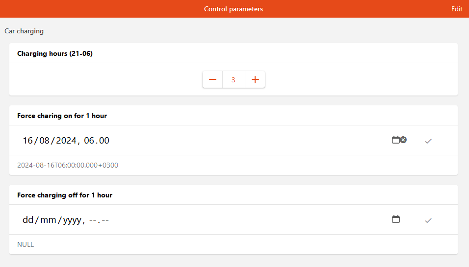

@somy I have a very similar use case with the car that you have since I don’t need to charge it every day.
I have solved my need with an user interface like this:
Yesterday evening our car was had only 30% so I had a need to charge it for 3 hours. So I updated an openHAB Item to have value 3. The change of this value invoked a Rule which found the cheapest 3 hours last night.

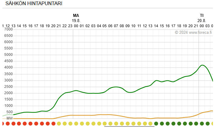

As I mentioned in my previous post, I use the wind power forecasts as a crystal ball to look further to the future than just 1 day. For example, at the moment it looks like Monday evening and the night between Monday and Tuesday is going to be significantly cheap because there is going to be so much wind power production that the prices will go to zero (if not negative).
Unfortunately this data is not open data in a sense that I could get it to openHAB so I need to manually check the wind power forecast from the website and then I can manually determine when to charge and when not (i.e. when to put the charging need to 0 in openHAB and when to adjust the Item to a higher value).

Okay, concrete example from the upcoming weekend.
I know that I will drive at least 250 km during the weekend.
I see tomorrow nights prices and can say that they are moderately cheap. Based on the wind power forecast I can see that the night between Sat and Sun is most likely going to be more expensive. But the night between Sunday and Monday is most likely going to be much cheaper than these two upcoming nights.
Conclusion: I charge my car only 1 hour this night. That will be enough for the weekend rides. This means I have to charge on the night between Sunday and Monday no matter what but I’m okay with this because my confidence level based on my previous experience is high enough that the assumptions I’m making are good enough.
