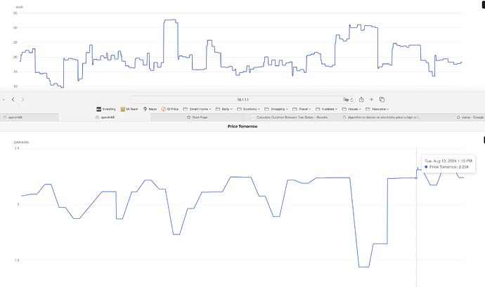

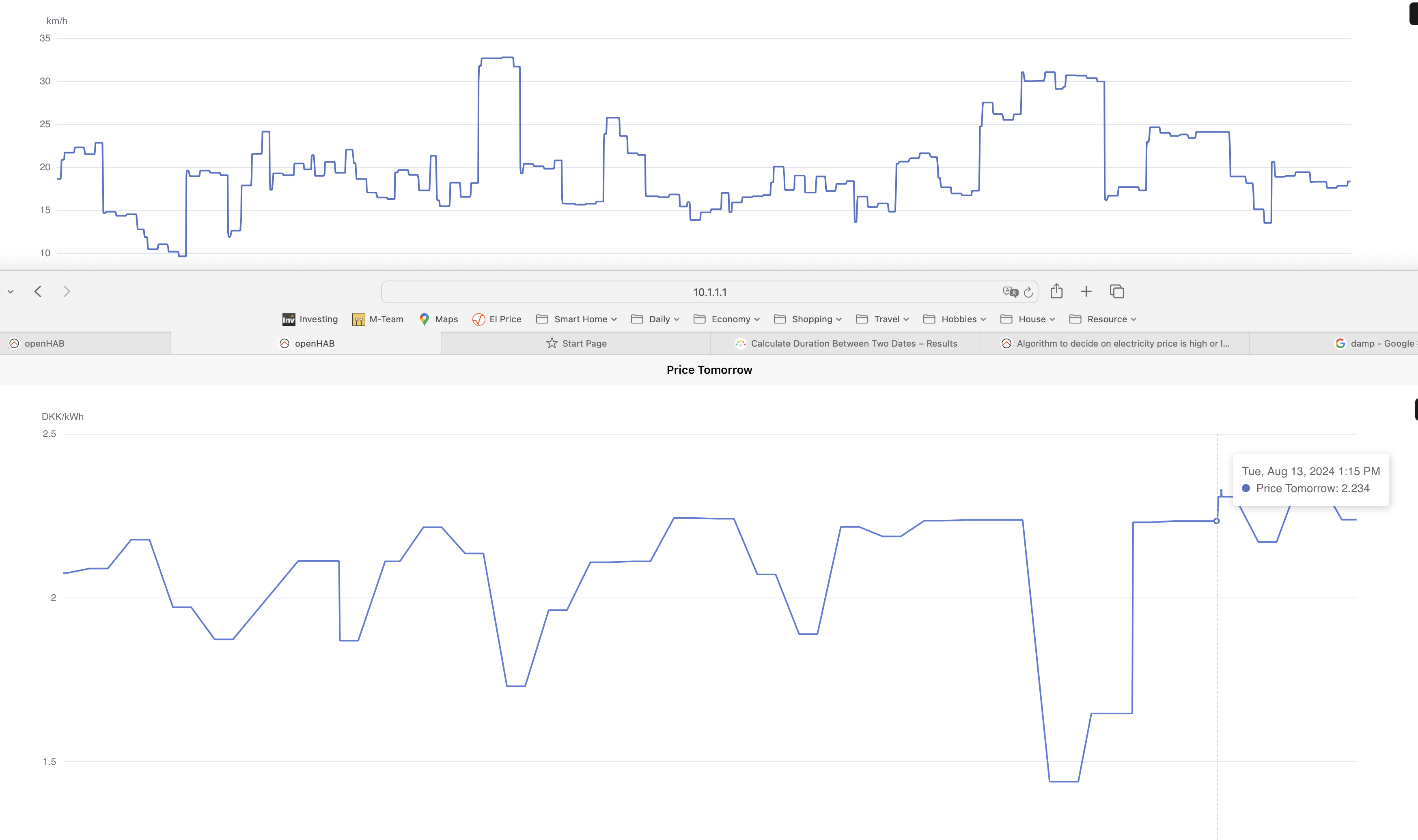

I’m now trying to plot the wind speed data from OpenWeatherMap and el price. I believe there is strong correlation (what I got for 1 month data):
Something for example: if tomorrow’s wind speed above 30km/h, there is a chance the el price will be lower than today (maybe I need some safety margin). It’s not going to be right every time, but as soon as it’s right more than 50% of time I’m happy :slight_smile:
Yes, there is a strong correlation but you can also see from this sample with a naked eye that the wind speed is not the only factor in this as it does not explain all the peaks and dips in your screenshot.
In other words, there are other significant factors. Like outdoor temperature (especially during winter when people need to heat their houses), day of the week (many factories are closed during weekends), time of the day (many factories are closed during nights, people tend to use kitchen more at certain times), public holidays, downtime of production facilities (see Nordpool UMM messages), downtime of major factories like paper mills and steel factories that normally consume lots of electricity (see Nordpool UMM messages), downtime of transfer lines between the countries and areas within countries (see Nordpool UMM messages).
Point being: there are so many factors that you need a machine learning model for this. The best model I’ve seen for this is the Sahovatkain I linked earlier and even that is not very accurate anymore.

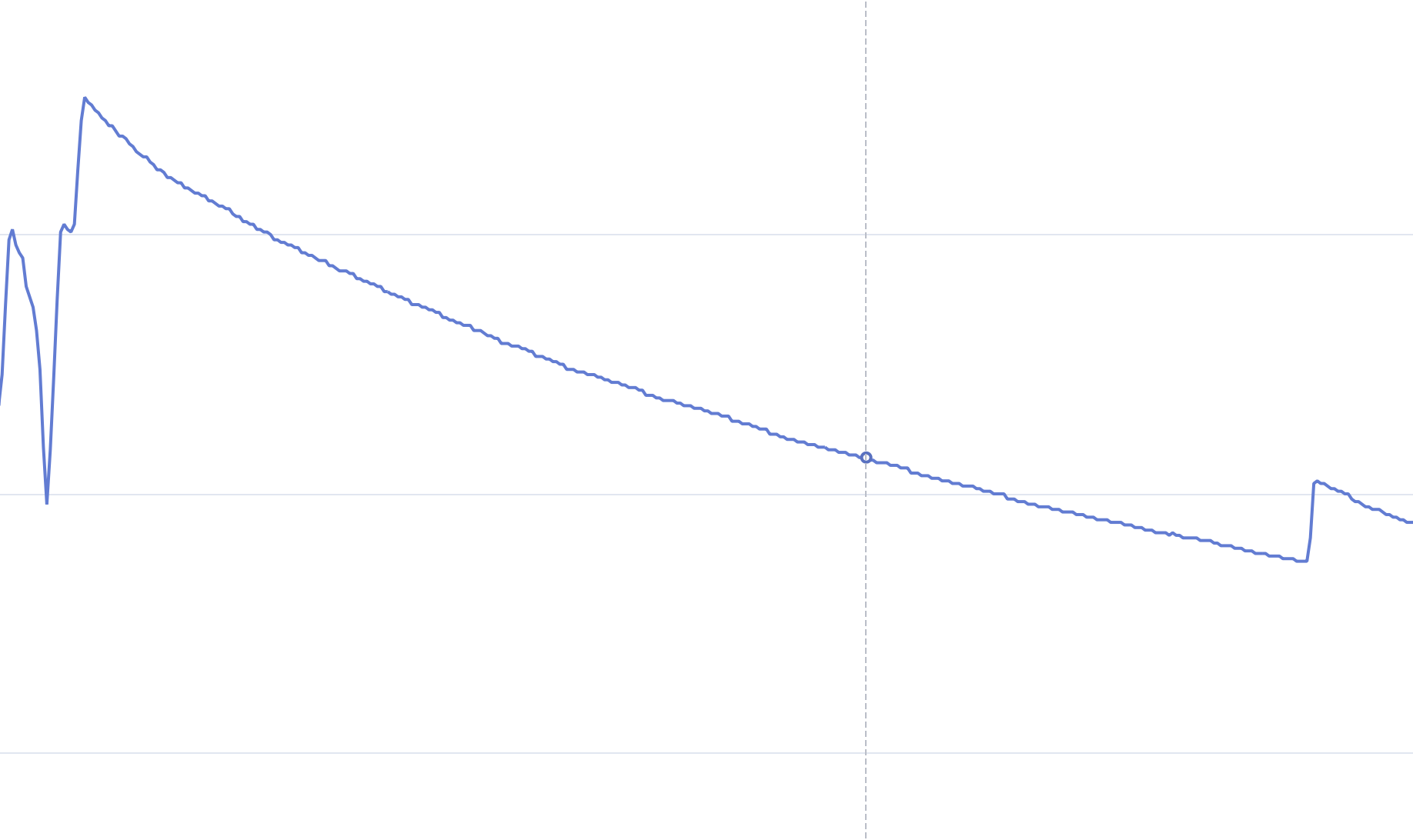

Note for myself: when I was on vacation I captured the temperature drop of my water tank
Anybody know a good way to create equation based on the data points?
ChatGPT recommended Desmos.com or just providing the data for chatgpt so that it can give you the equation for the curve.
