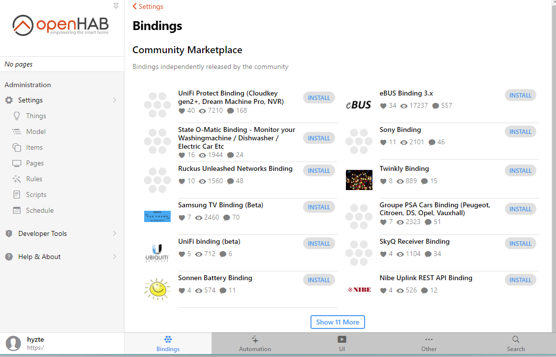

All bindings have disappeard after reboot
I was trying to update my OpenWebNet binding to latest version; it was working actually, but after a restart I don’t see any binding!
Even if I want to add one, I don’t see anything available.
I am using openHAB 3.2.0 - Release Build on a raspberry (Raspbian GNU/Linux 10 (buster))
What can I do to revert to normal?
This is the Bindings list I see, where there used to be all my installed bindings :
This is my log when starting openHab:
