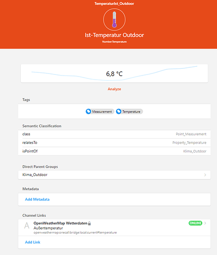

This item I have choosen for debugging.
I don’t find an error in the openhab.log and added some info logs in my rules which are always get called when the item changes:

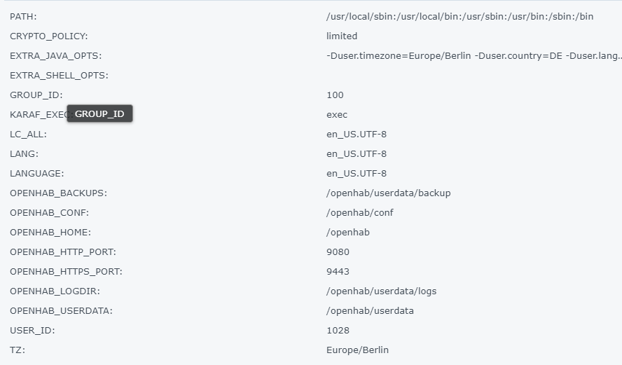

My docker variables are:
I checked this on bash:
adminDSM@DS716:/volume1/SmartHome/docker/openHAB/userdata/jsondb$ id openhab
uid=1033(openhab) gid=100(users) groups=100(users),65537(dialout),65536(openhab)
adminDSM@DS716:/volume1/SmartHome/docker/openHAB/userdata/jsondb$ id dockerlimited
uid=1028(dockerlimited) gid=100(users) groups=100(users)
I didn’t changed this for ages. Do I have a problem with rights and ownership?
Shouldn’t all files be from user openhab and user openhab?
I’m very confused now.
ah okay.
If I run a bash in the docker container user and group are still openhab. So this is all right then.

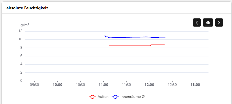

The chart page stopped showing the data when I restarted OpenHAB at 12:00:
This chart visualizes data from 3 items:
ST30Temperaturesalon_Temperature
ZWaveNode035ZMNHJDFlushPilot_Dimmer
RdC_temperature_requise

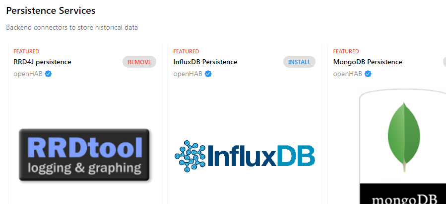

So I added InfluxDB as a second persistence service (leaving RRD4j the default) and was happy to see that there all values are kept up-to-date even after days and weeks runtime. As I had a Docker with InfluxDB already anyway (and another one with Grafana) that was on my to-do list anyway.
Maybe I could simply have removed RRD4j persistence and/or switched default to InfluxDB without ever missing it, but as I had enough diskspace and (like I assumed) performance to run both I kept it like that. And to be honest, I didn’t want to break something I might have not yet understood in all of its aspects neither. As I started with OpenHAB somewhere last year I first rather concentrated on adding all my things and items into the model in my spare time, instead of how to optimize persistence (or even pick the best persistence service for my need).

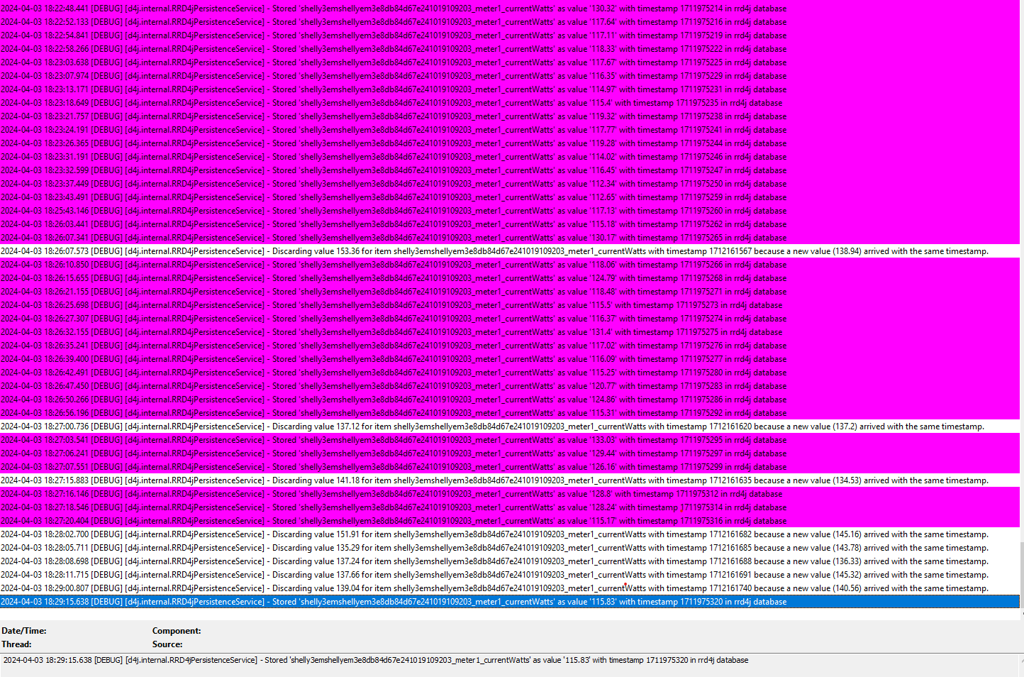

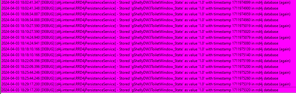

But now, that I enabled Trace logging for RRD4j persistence it looks slightly different.
Filtered on just one of the items to better show what happens:
So for me it looks like it has a serious backlog and getting worse.
See the first entry logged at 2024-04-03 18:22:48:
it is storing a value sent at 2024-04-01 14:40:14 (timestamp 1711975214)
and the last one logged at 2024-04-03 18:29:15:
it is storing a value sent at 2024-04-01 14:42:00 (timestamp 1711975320)
So in ~6.5 minutes it was able to only store values of ~1.75 minutes (from meanwhile almost two days ago!). And in deed, the OpenHAB graphs show the values up to that very timestamp.
While those that are being logged with a current timestame 1712161xxx (=the white ones) were all discarded, due to “new value arrived with same timestamp”, but strangely that one is not logged here at all. Maybe it will in 2-3 days, when the processing finally reaches that timestamp. Who knows.
Looks like I can observe the above for every item. A little difference to the energy meter values above though can be seen for the values that are not reported that often:
There (with the same delay in timestamps) it looks like each one is processed twice, which looks strange to me as well but could be as expected.
Sorry for the long text. But wanted to draw a bigger picture than a text like “maybe it doesn’t stop saving completely although it appears to, but creates a massive backlog” could have done.
This might help the developers a lot. best would be if you add it also to the issue in github were they will be looking at: [rrd4j] Persistence stops saving data suddenly (mapDB not active) · Issue #15794 · openhab/openhab-addons · GitHub
